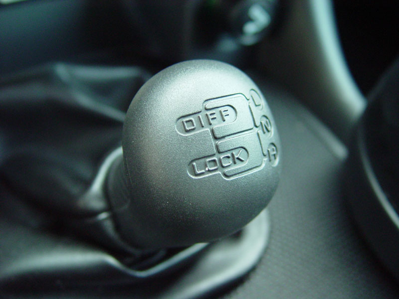

i assume your shifter handle on an 04 should look like this picture.
it is quite possible that the cable has froze up from not being used.
