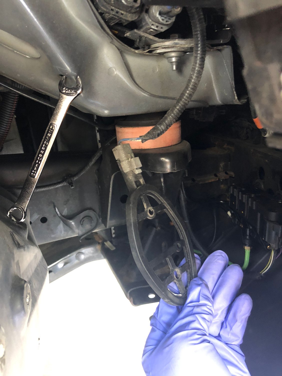

I replaced the front valve block today and noticed two plastic bits hanging. By looking at the other side I noticed there is a cover that cracked and covers the cv axle. Does anyone know what this is called or have a part number? The guys at LR can’t find it and I can’t find one online.
ALSO
If anyone finds themselves removing the fender well remember to remember this plastic bit that sits on top of the fender well. Sorry I’m not sure what it is (owned this LR3 for a few weeks) but I don’t trust anything not being put back where it used to be on this computer-on-wheels
Cheers,
Rocco
Plastic bits from cover

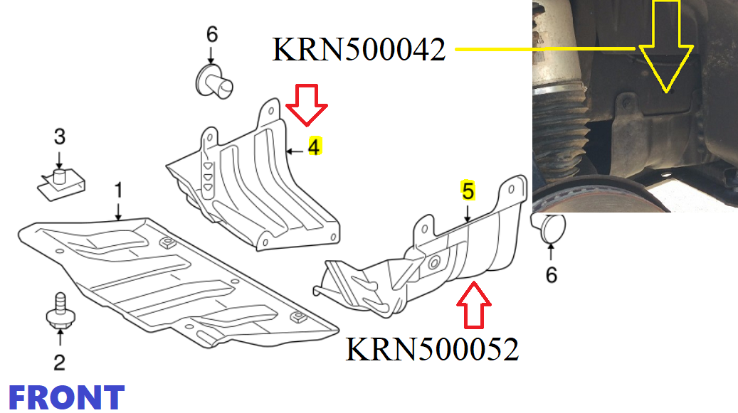

I can only see your first pic, but the cracked "tabs" were for the side mud/splash shields.
The Land Rover Dealer couldn't tell you that these are....
Pass Side (RH) Part #: KRN500042 AND Drivers Side (LH) Part #: KRN500052
> https://parts.landroverftmyers.com/oem-parts/land-rover-side-shield-krn500042
> https://parts.landroverftmyers.com/o...ield-krn500052

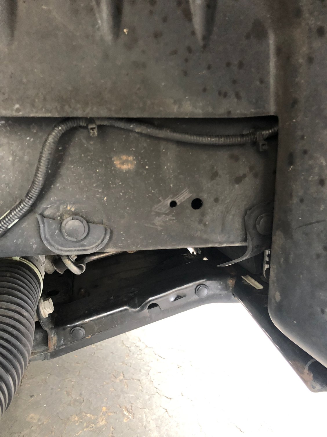

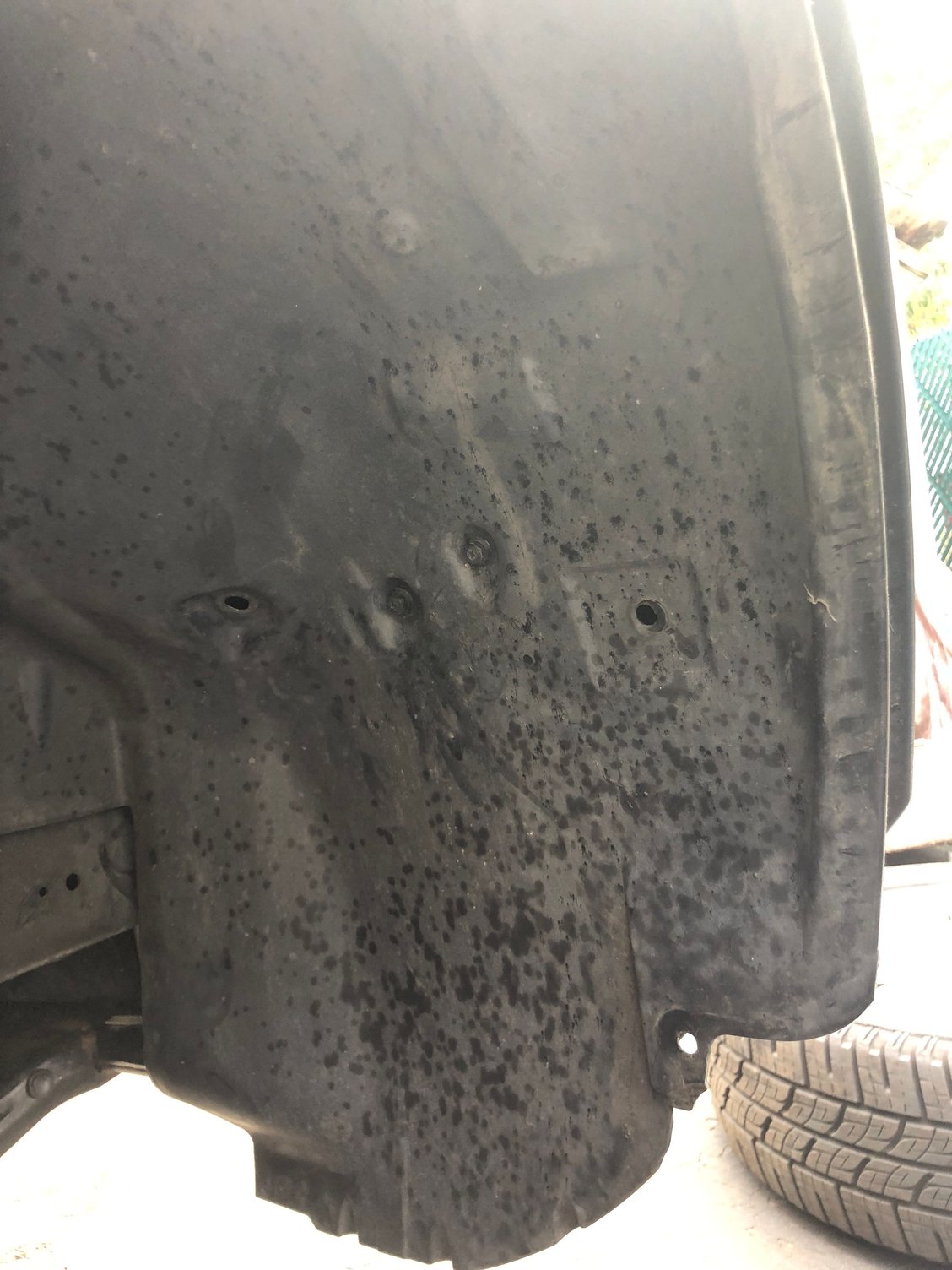

Your second picture is the tire pressure initiator. Its the component that "excites" the tire pressure sensor and reads the pressure, then transmits the signal to the tire pressure module. 3rd picture is where the initiator should go mounted to, on the back side of the wheel arch liner. Hope this helps.
