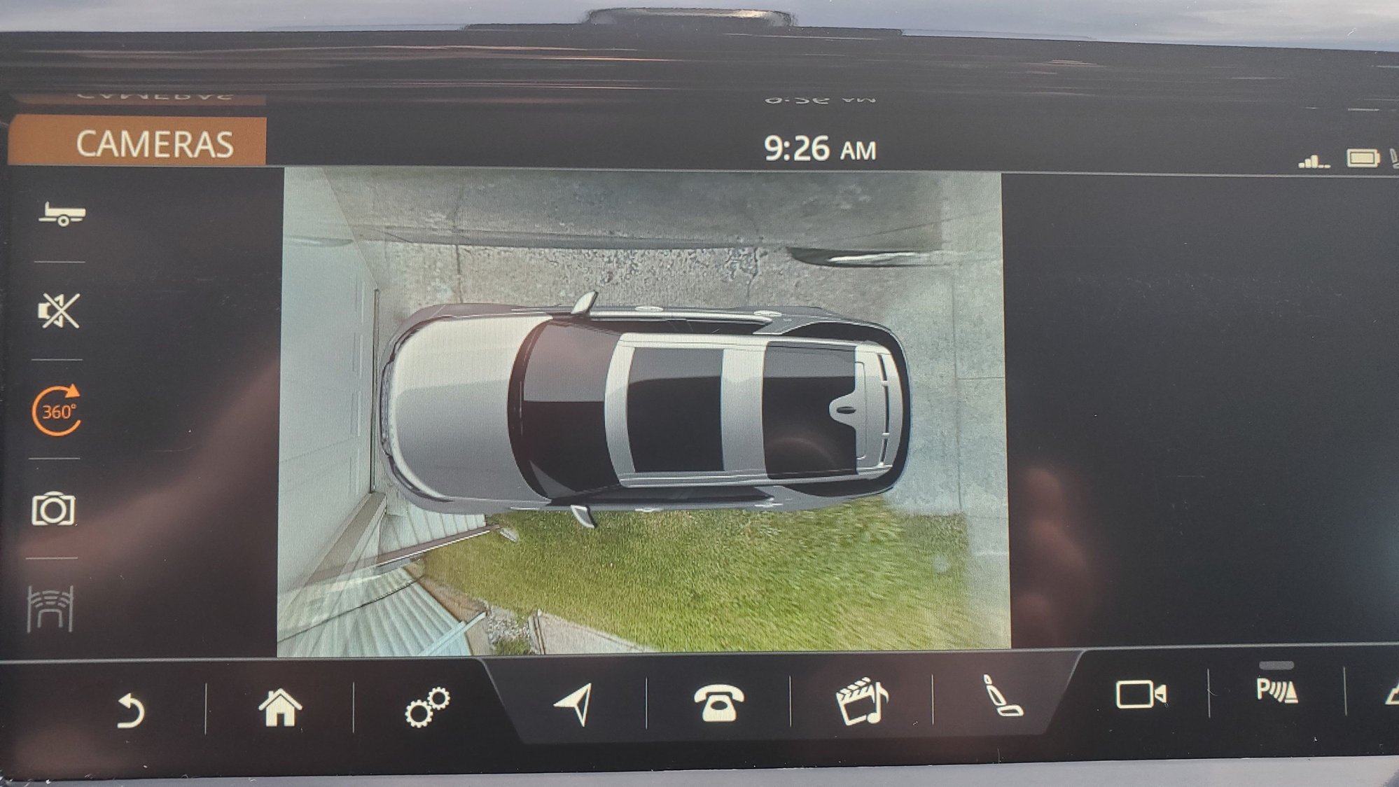

The camera image displayed on screen for my passenger side mirror is flipped vertically. I noticed a bit of a strange movement on the 360 camera view and decided to check out each of the four cameras individually (front, back, driver, passenger). The easiest way to explain it is the photo below. The wheel and tire on the passenger side is the front tire, but it appears at the back of the vehicle. I haven't had any recent repairs or damage to any part of the car. A software update from a month or so ago is the only potential cause I can think of. The physical camera looks normal under the mirror with no apparent damage or tampering. Has anyone experienced this?
I'd be relieved for someone to tell me it's User Error and I can walk away looking silly rather than taking this to a dealer! The mirror is extended, not folded up. I can't think of any other obvious things to post so I look forward to what you share with me!

Had the same issue, happened to me after i changed the car battery.
Managed to fix the issue by removing the camera from the side mirror, starting the car, switching the car off and finally putting the camera back.
Returned back to normal, hope this helps.
