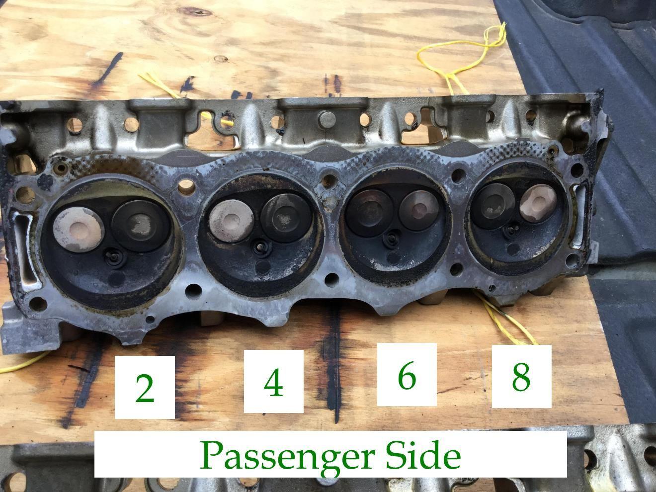

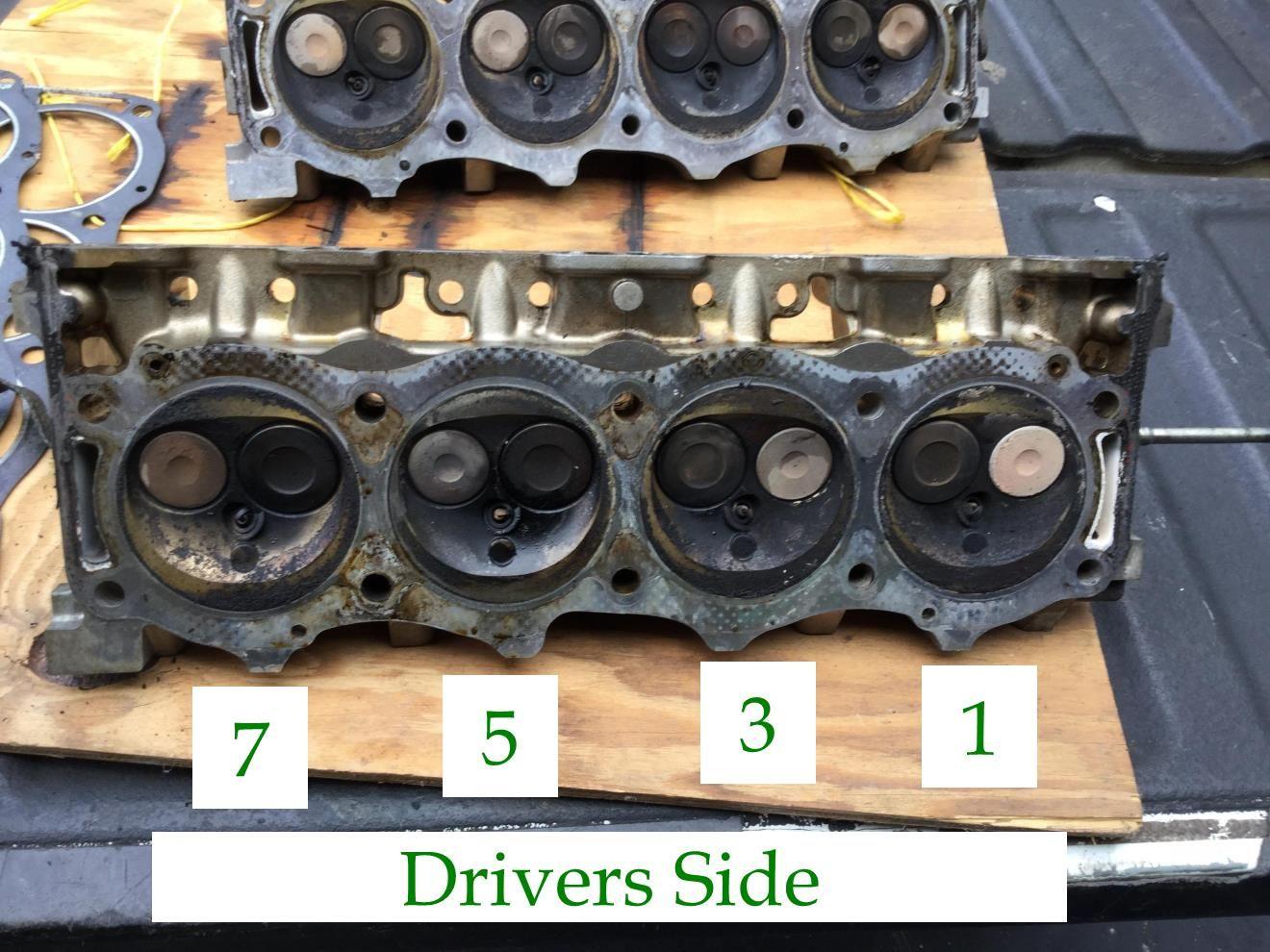

Update .... Attached are pictures of the heads and gaskets removed from the heads.
Also, the machine shop called today, pressure test on heads good, pressure test on valves good. They stated that the heads needed to be machined down to flat.
So my conundrum ... is there enough evidence on the block, heads and gasket of a gasket failure? Or is there potentially slipped liner or cracked block?

Update ...... Talked with the machine shop yesterday. Pressure test on heads (including valves) came back ok. They said the heads needed to be machined down but did not look bad.
Attached are pictures of heads and gaskets. To my uneducated eye there does not look like big problems.
Now I wonder, am i fixing my problems or should I go further and test for cracked block or slipped sleeve?

I would be concerned that the steam cleaned piston was an indication of a crack in the block behind the liner.
do you have the gaskets to confirm it failed on the steam cleaned piston? Being that it's a middle cylinder is more alarming than at the back where you have coolant passages.
You say HGs were replaced twice, was that recently or during the span of the 225k miles?
edit: check those gaskets for the breach. If one does not correspond with the steam cleaned piston, might be a crack.

I don'r really see evidence that the gaskets failed. However, there is no doubt that coolant is in the system due to the steam cleaned piston. Also, seeing that piston #5 is the main culprit the it leads me to believe I have a block issue.
I have read that its not uncommon that these blocks develop stress cracks around the cylinder walls near the head bolts. My oil has never seemed milky and a crack between block and liner would push fluid both to the combustion chamber and inside block correct?
One thing that is puzzling is the head bolt hole between #5 & #7. Seems to show signs of burnt fluid, however the gasket itself does not look like it failed.
Is it possible that there is a crack in the block between the head bolt hole and water jacket around the piston wall? And the fluid migrates up the threads of the head bolt?
If so, would that also explain the pressure in the coolant system?
Oh the calamity of it all ...... heads are being milled, as stated above, valves are seating well and everything there pressure tested ok.
Now i am trying to decide, do i pull the engine? Should I invest in the kit that will let me test the block in the vehicle. Or do I expect a problem with the block and get a new/use one and quit trying to figure it out?

I would go with cracked block.
As far as the block test, it’s very hard to replicate running temps and other factors while bench testing a block.
i have gotten a motor up to temp, then removed all the spark plugs and administered a leak down test with results being negative for cracked block/blown head gasket. Although it was clear that #5 was steam cleaned and the system was over pressurized.
