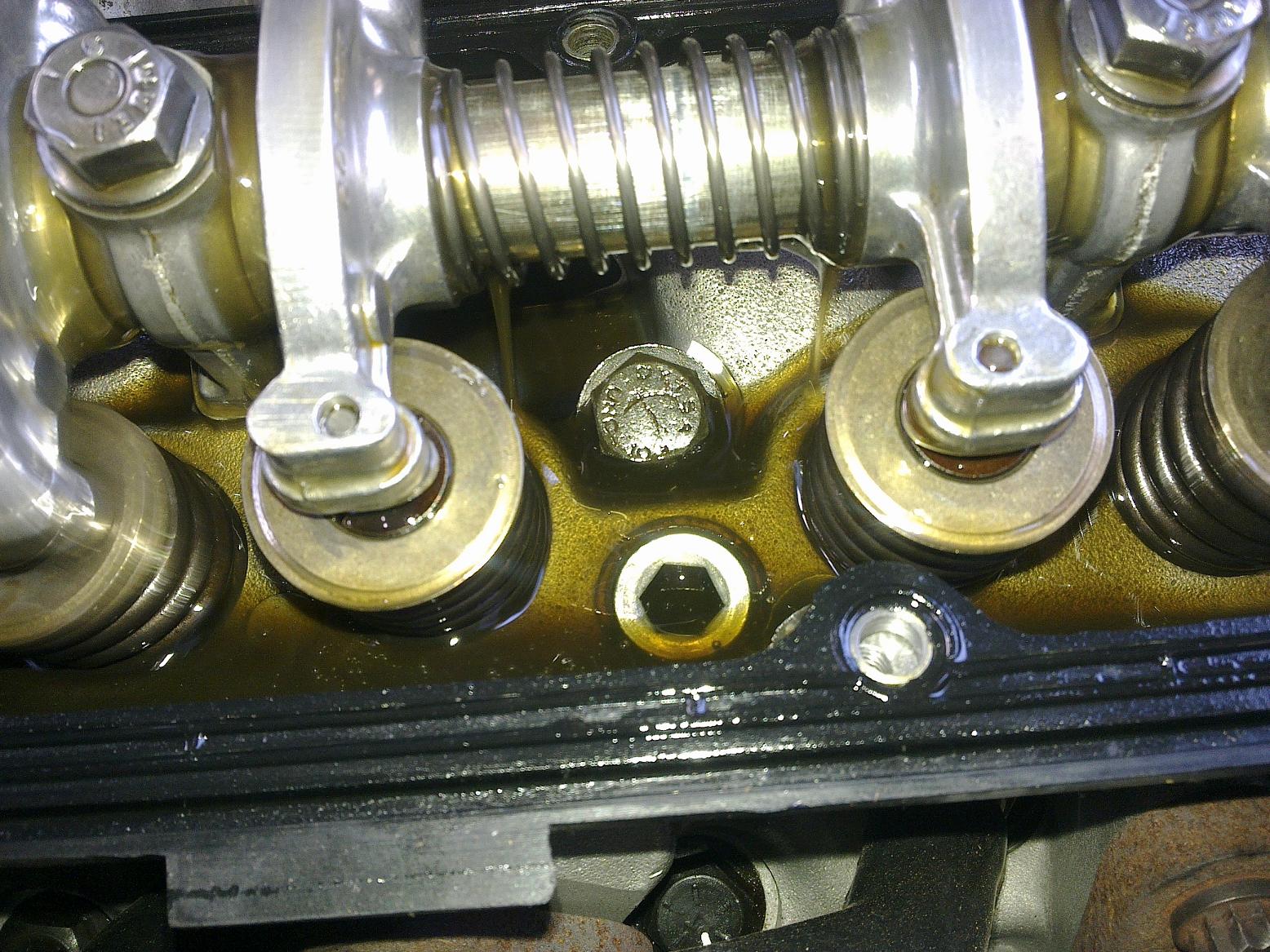

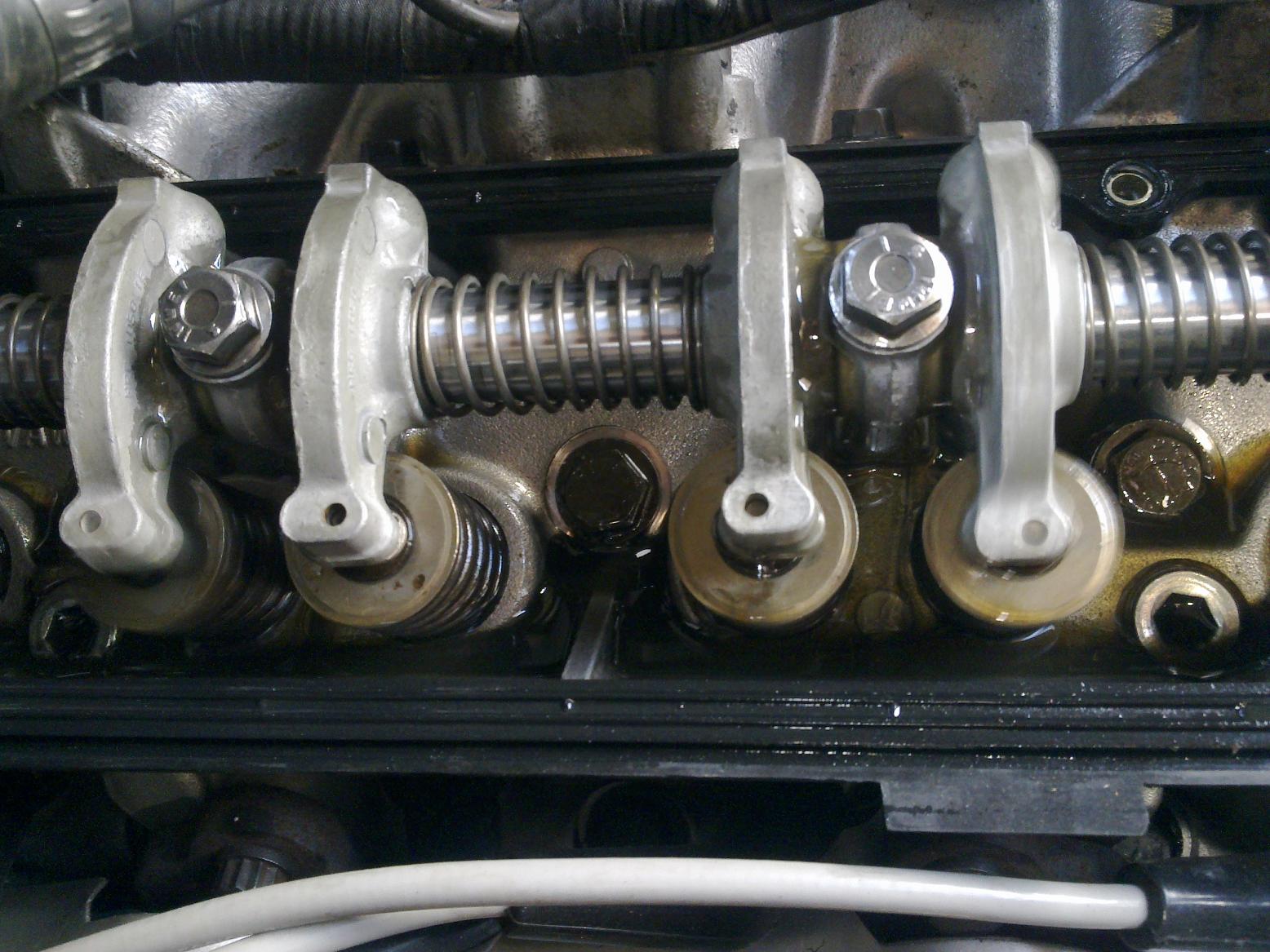

you should also check the fit of the rockers on the shaft, those pockets of black tar like substance leads "me" to believe the rockers are worn and allowing to much oil to sit in the heads.
the first picture is proper oil flow running
the 2nd is with worn rocker arms & shafts runnning.
as you can see the oil is escaping between the rocker and shafts, no restriction = no pressure

Awesome, thanks for adding those pictures! I'll tear mine all apart to see what the clearances are like, but I'm sure it'll probably be like everything else already is, worn out, lol.
