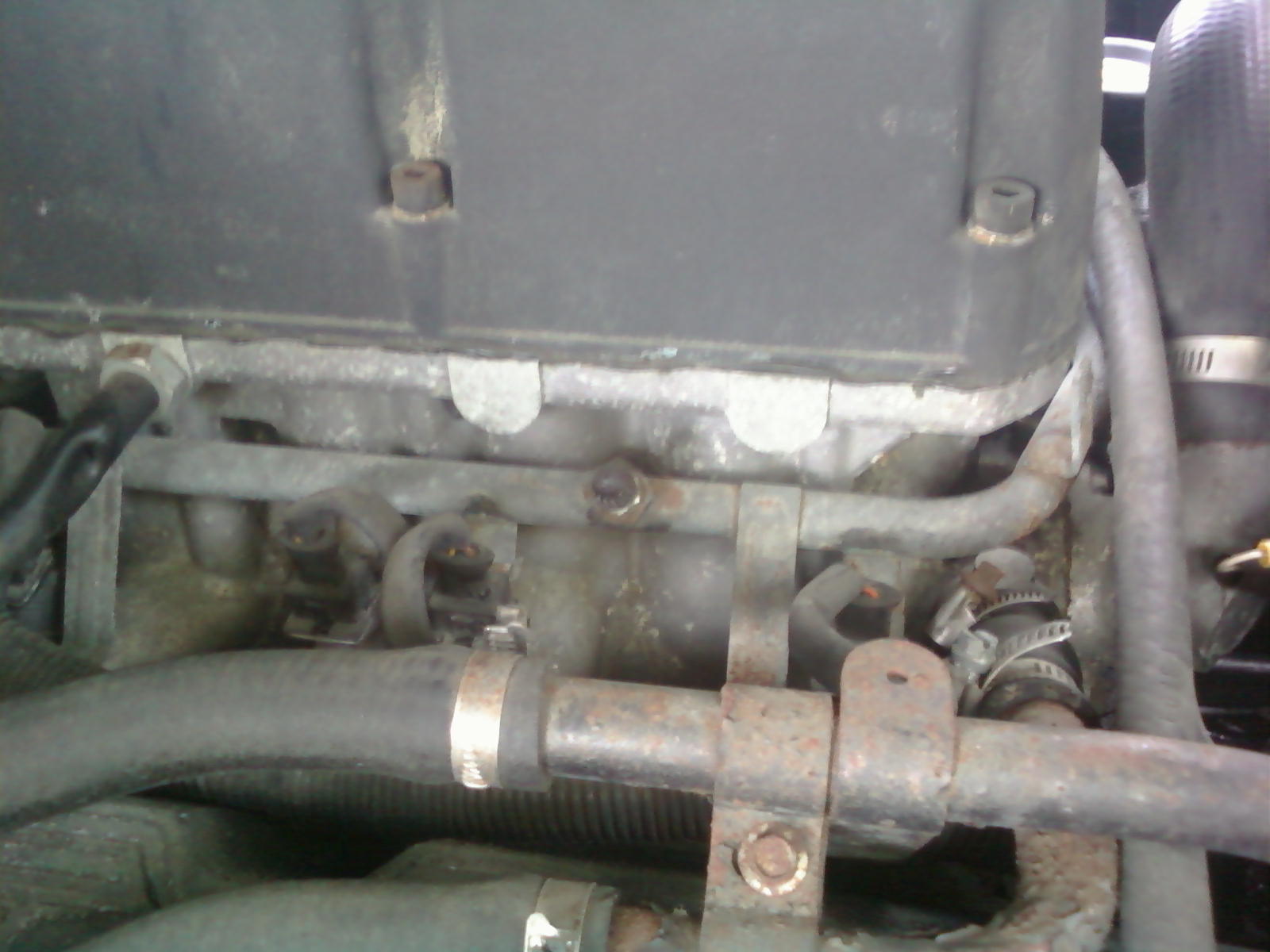

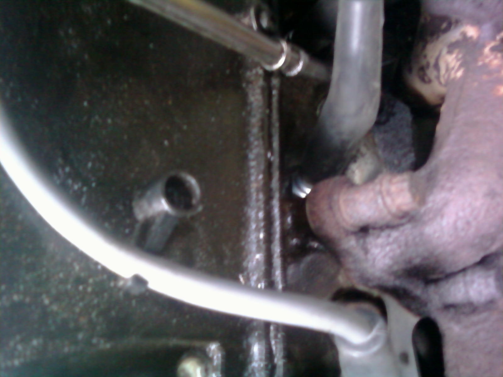

I went to check if the drip stick smelled of gas. Maybe a bit couldn't tell not strong. I also noticed what looks like a bicyle plug on the engine. See photos where it looks like hoses should be but aren't. Opinions?
Attached Thumbnails Is engine really dead?-p_00654.jpg   Is engine really dead?-p_00651.jpg   Is engine really dead?-p_00650.jpg

Pic 1: Fuel rail pressure valve.
Pic 2: Hood switch plunger, its ok.
Pic 3: Spark plug wire retainer clip, its ok.

In pic 1 you might want to replace the hose/ valve cover to ram housing. Just get the kit > PCV Tune-Up Kit For GEMS Engines | Land Rover Engine Parts
Simple install >
