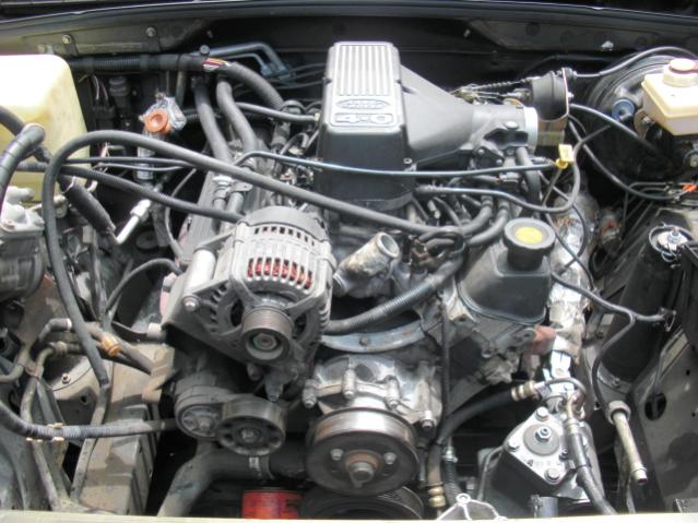

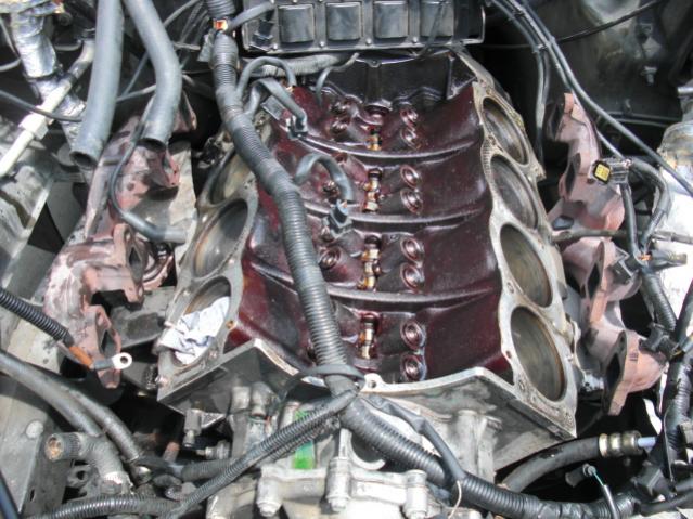

ok so we got the gasket kit....were ready to go to work .start of by removing the pully system pwr steering pump, alt ,ac comp.etc..then we move to the intake manifold, vavle covers, rocker arms,etc all good ..now we unbolt the exhaust manifold still all good..now it's time to remove the heads thats where we had are only problem one of the bolts broke (BUMMER!!!)...so we called it quits for the day. the next day i called my brother to help me get the broken bolt out ...the good thing was that the bolt broke with about a quater inch sticking out ...so he shows up with a welder and welds a nut to it and with a little heat and some elbow grease we get the bolt out...so we remove the gaskets one of them looked pretty bad (see pic) soo to make a long story short we changed the gaskets replaced the bolts and replaced a bad rocker arm...get it put back together and everything sounds good no more water fall noise under the dash..and the temp stays right below half now the only is now is fixing a brake problem ...ooh yeah also replaced the fan clutch...so far so good
