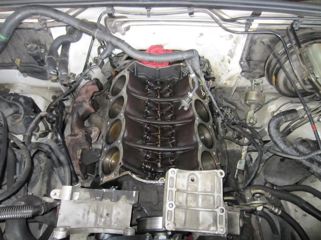

You will have lots of pieces left over from the kit unless you change every little thing. And kits can be for more than 1 version of the engine. I kept all the extras. The machine shop wants the little box with valve seals.
In you pix, note the index studs (two per head). They allow some shift of the head when set back on the block. Use the old valley pan gasket to line it up before torque of head bolts, or valley pan and intake have problems fitting. The heads can be nudged a bit with hammer (tapped), etc.
The front and rear small bolt that holds the "lip" seal can be easily stripped. Honking it down spits the rubber seal, and pieces of it end up in the oil. RTV is used on the corners in that area.
The cam shaft area should be shielded with a shop towel, etc. It is amazing how gravity sucks small parts into those spaces. Small valve cover gasket rings roll down hill rapidly. Count your sockets before closing it up, one member posted a photo of a box end wrench left on top of the cam area by his mechanic.
Of course keep push rods arranged to go back in same spot, and you may find lifters have "mushroomed" and won't come out the top. If you remove cam they will drop out the bottom (unless held two by two with rubber bands).
You are at the point where you realize just how far you want to go with "while I have it open" issues.
