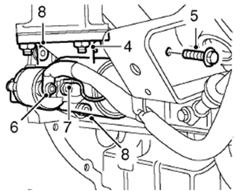

Some folks have success going down between the manifold pipes and back with sum universal socket joints, others seem to be able to get right up on it at near the firewall. I guess it depends on your back and arm/hand size. Also, if you have the heat shield over the starter, the bolt to remove it #5 below is in a bracket out front on the motor housing on the front left. Very shallow bolt head, so take it easy. Then the heat shield has a big flexible/spring steel C shape clamp that holds it to the starter. Pull up on it and it will slip off, bascilly, well maybe not slip. You have to do a little bending and shaping to get the heat shield out, but it is flexible and has the 90 degree bend on the front where it bolts to that front mount point. I wanted to put mine back on, but gave up on it. Most guys run without it.
