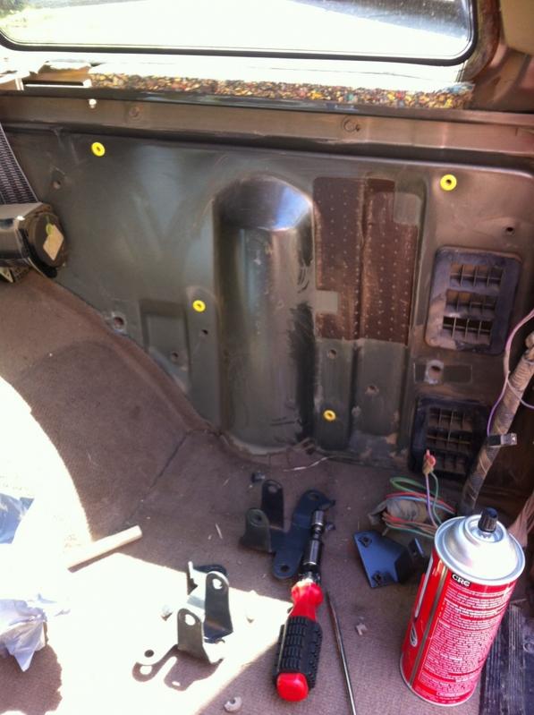

Step one: remove Trim piece and locate mounting holes. Seat belt mounts were coverd in tape and bracket mount holes had plastic inserts.
Step two: Install 4 Brackets two high and two low.
Make sure you align the seat belt bolts before tightening the rest of the bracket

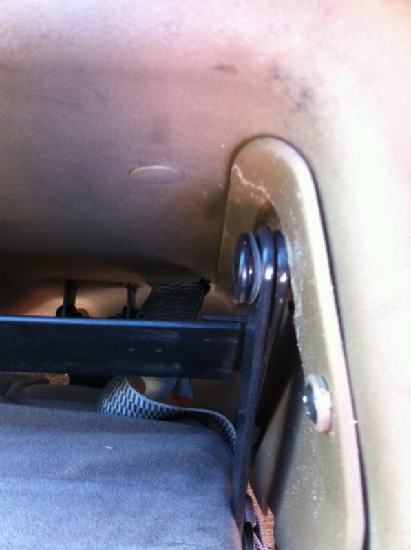

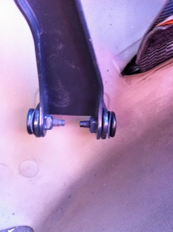

Step four: Fit bottom ,then top seat brackets in place. Torx Bit #30 required.
Note: You cant see it here but on the right side clearance is minimal.
My Torx socket was only an inch long but would not.
Now the top bracket,:
