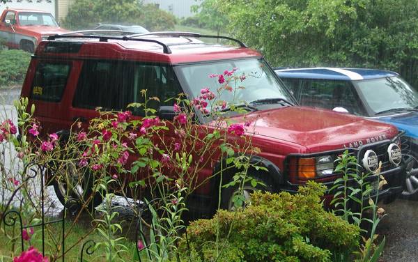

Thank you Dusty 1. Yeah I did some searching and tho not exactly common it seems that bad hg can make some "knocking" sounds, especially if gasses are getting swapped between cylinders? Anyway I own it lol. Figure that the motor has such low miles, the PO swore that they didn't get it red hot, I'll get lucky. If not, heck I'll just fix that too. I was wrong tho, it's a 99, not a 2002.
