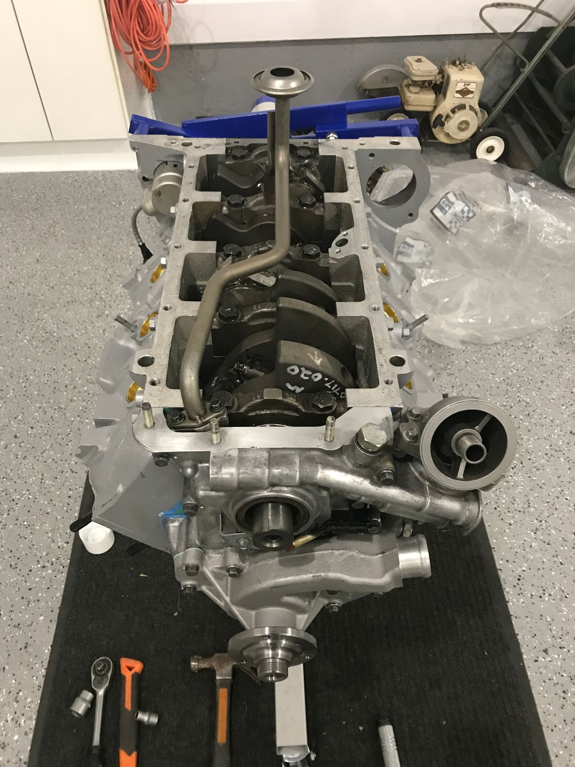

I rebuilt the engine of my 04 disco (4.6l) about two months back (top hat liner time) and it seems to be running good, I’ve done about 2kmiles since the build. I got some early cylinder misfire codes after the build but they went away.

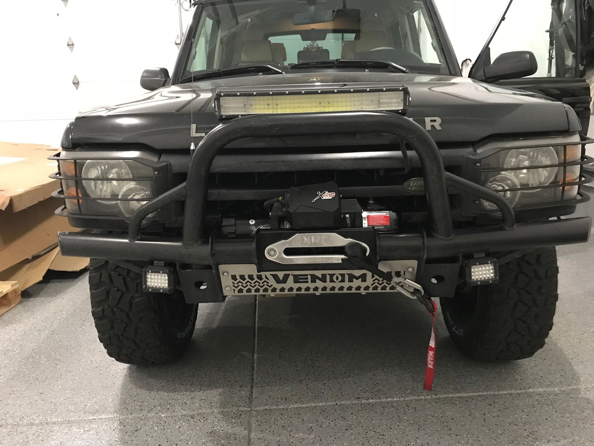

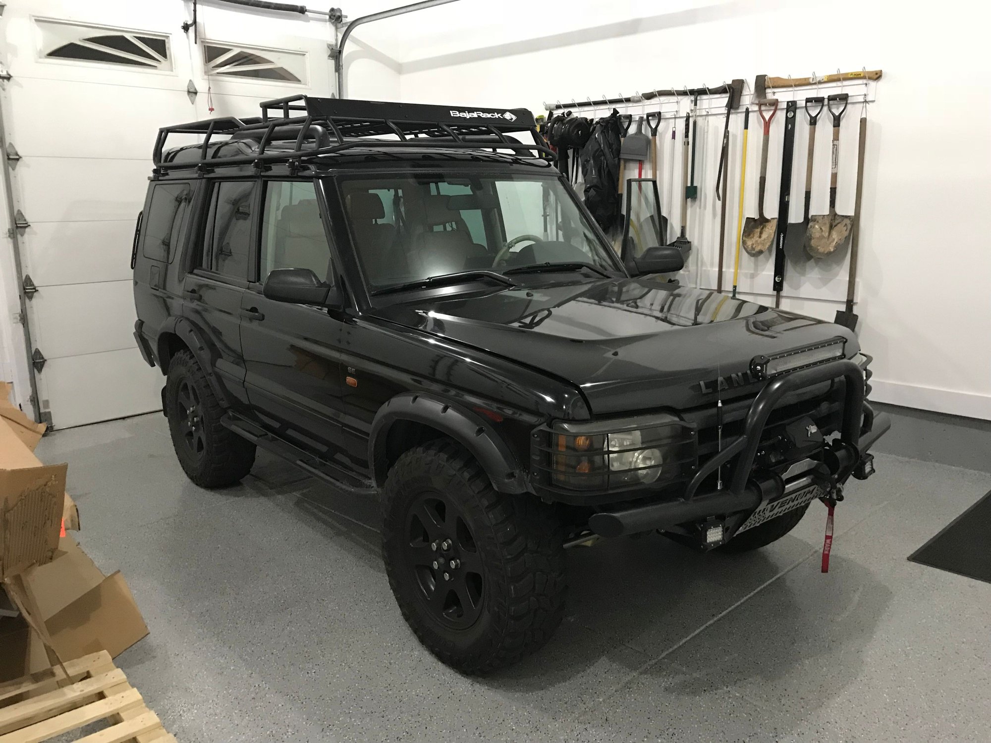

That is a very nice looking truck! Nicely done.

Thanks dude. It’s actually my wife’s daily. After the rebuild I just said what the heck and bit the bullet on a bunch of stuff I have been wanting to do for years.
