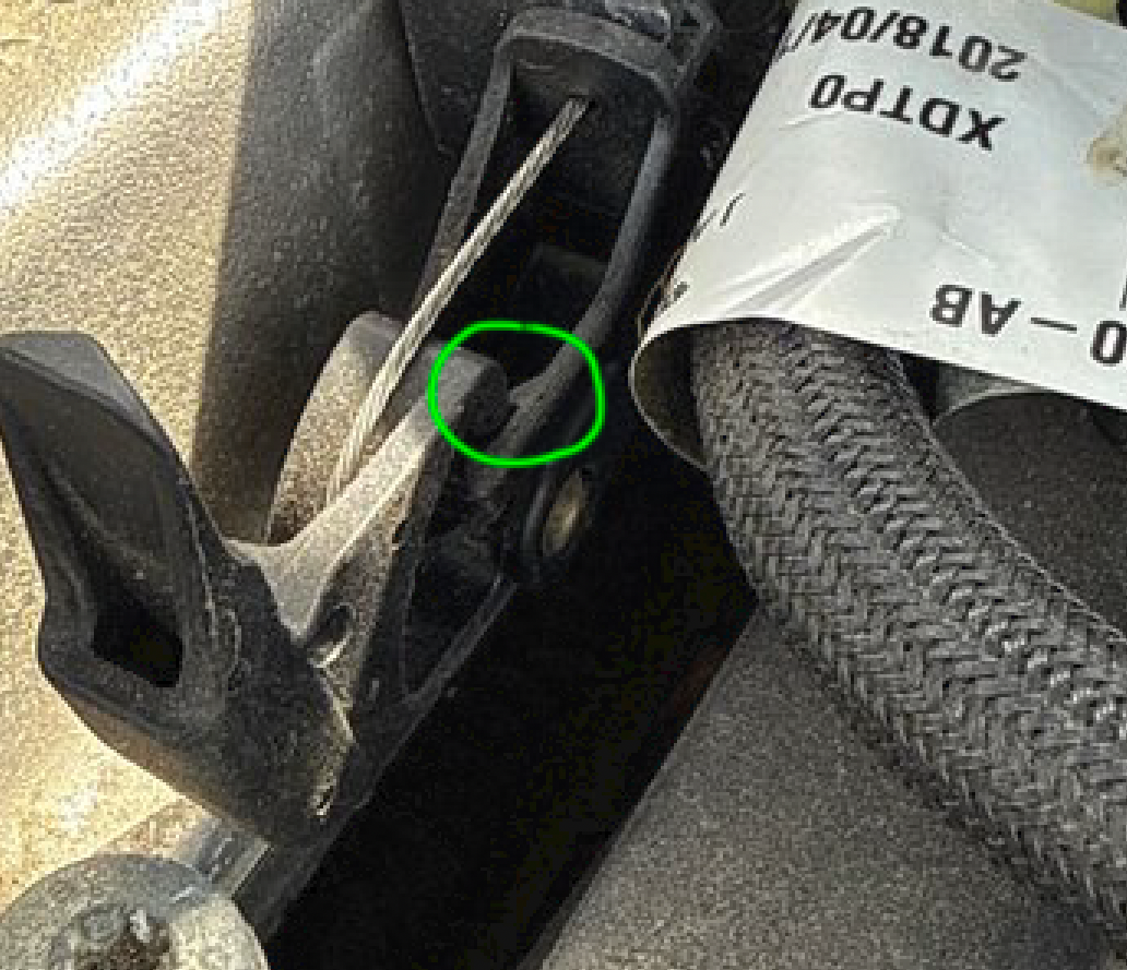

Just gently bend it out with a flat screwdriver or such. You can see in the pic where it is catching.

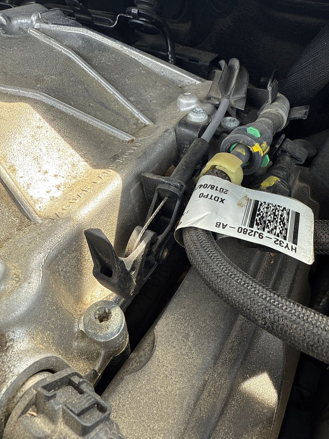

Another pic...

You really saved my bacon today, thank you, thank you!
I was afraid I was going to break something since the deflection took some force and I broke a pen doing so.
