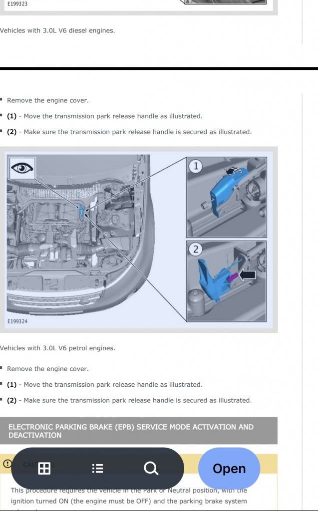

Hi folks, my 2018 land rover discovery is leaking gas after dealer service, likely from the high flow fuel pump/gas lines (the metal ones). Car needs to be towed but I can't put in neutral with the engine off (the automatic gear is not stick, it is like those buttons that go up when the car is on and down when the car is off). What is the procedure to put the car in neutral and off the parking brakes without turning on the car? Essentially with the ignition on but not starting the engine and keeping the engine off. Please help, thanks.

I don't have a picture, but the release is on top of the engine.
I'll look for a picture.
