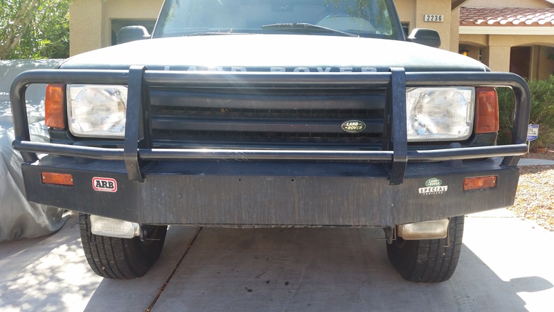

I got a ARB bumper that doesn't have a whole for the fair lead. Is there a difference in structure or strength compared to the model with the winch provisions? I know ARB wasn't my first choice but it was free (almost) . Can I just cut a hole for the lead?

I found the answer on the IH8MUD forum I used to belong to with my FJ80. Those guys simply reinforce the front with 3/8 plate. Mount the winch there. Then cut a hole for the fairlead.

Your bumper has no hole in the middle and no holes for fog lights... it MUST be stronger.

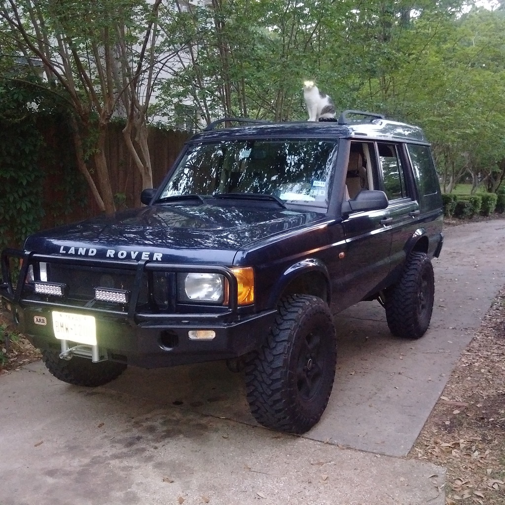

I just put fogs up high. Well, really I don't know if those can be called fogs because they are so bright they blind me and everyone else. I hate them.
Note how low the winch tray is... it is still in a bad spot for my license plate.

It is in the tray... the tray is just low... but not low enough to make room for a US license plate.
I used a harbor freight 12500 pound one and it fits perfectly.
