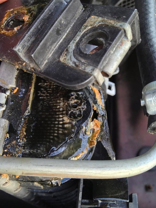

24.2 pints, if engine has fluid in it, 26.2 dry. That's for the whole cooling system. Problem is that if lower rows are cooler by 10F or more, the sludge inside may not move out. And gasket sealers in many cases decide to also attach to the sludge and calcium, making it a worse blockage.
Reverse flush all you can.
The heat gauge points at 50% from about 130F to 240F, so a scanner or Ultra Guage give a much better picture of what is going on. No need to get to 250 or 280. Should run under 220 in most cases. With one of the new 180F soft spring stats you'l be even cooler. But still need a 100% radiator, not one that is 50% full with sponge of gunk.
The plastic side tanks make it not profitable to rod out by the indy rad shops, my D1 was rodded out and hot flushed wih citric acid for $75. The D1 had copper and brass tanks, just un-solder. D2 rads can be had for $150 - $250. Be careful with the screws that attach to the top of the radiator, prime spot for plastic tank crack.
