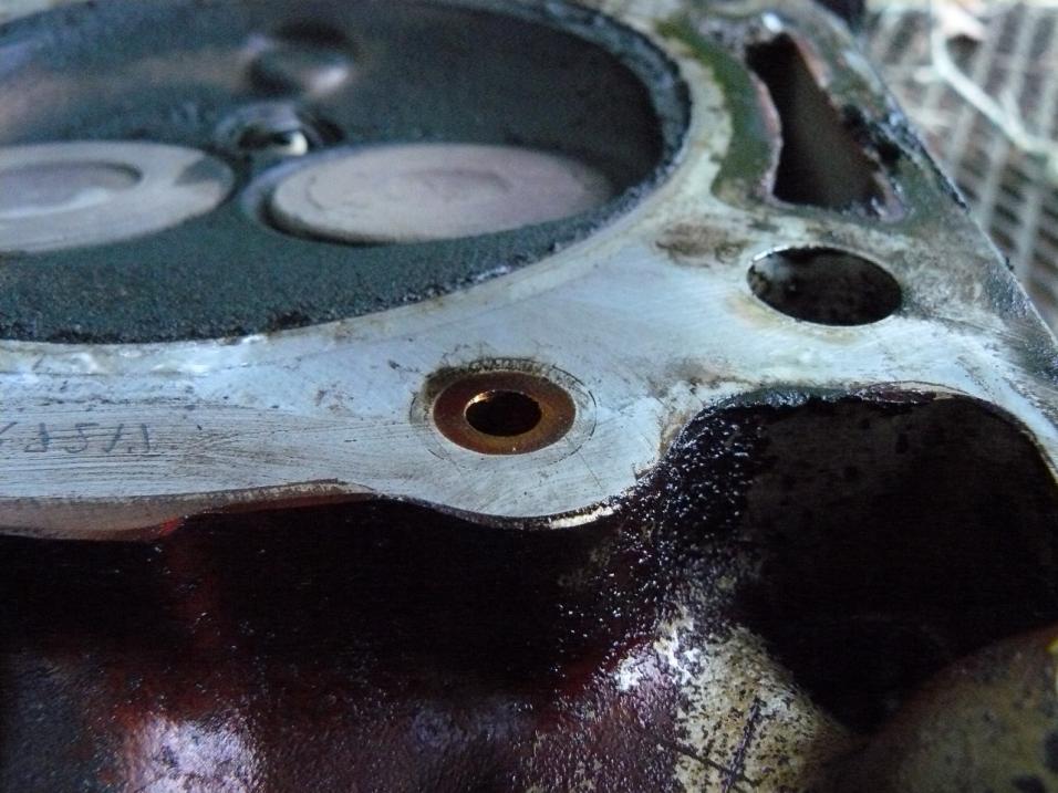

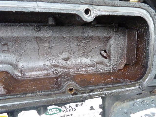

Oil leaks from valve covers are much more common, and can drip down to same place. They have 8mm 12 point bolts that need to be snugged up every oil change. Eventually the gaskets need to be changed, there is a metal spacer in the gasket at each hole, be careful those don't fall into the engine. Pix of 97 D1, note missing spacer. I found it, before it joined Elvis.
Also pix of the oil port location in the head, and it can leak external, it is the copper circle, which is a transfer imprint from the head gasket.
By my math skills, which are pretty rusty, the head gasket is a lot more expensive, and I hope that is not your problem.
