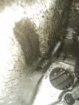

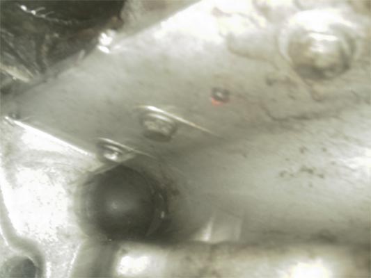

So I took a look underneath, and saw this plug hanging out. Tried to put it back in, but could not. There is one on the other side that is in, but bulged out. Not sure how to get this plug back in, do i nee a special tool? Could this be a/the source of a major oil leak?
