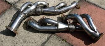

Does anyone have exhaust manifolds for a 2001 DII, that you could do a tracing for the ports and bolt? I'm going to have the part that bolts to the head cut with a waterjet. I don't think I'm going to find headers that will fit easily. I can bend and I can weld, found aftermarket collectors so I'll just do this myself.

I could take some off my parts truck and send to you if you make 2 sets of headers and sell me one

Why not grab a pair from a GEMS P38?

I have the Hedman RRC headers on my D2. They fit almost perfectly. The collector is pretty sh*t, but if you can weld then just cut and weld a v-band clamp or a slip joint on. That's what I plan to do when I take mine back out to do some work.
