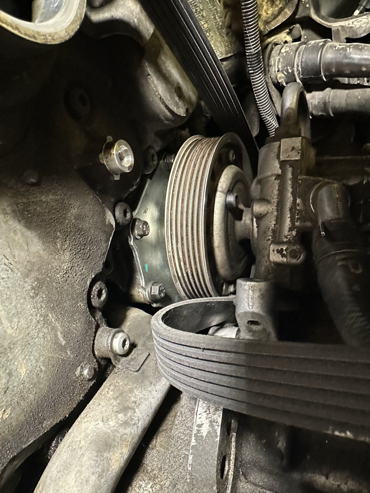

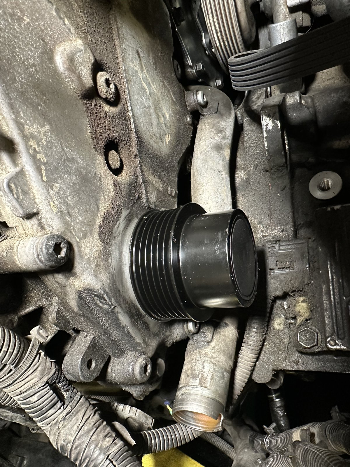

Sorry for the long lag. I've updated my email address today so as not to miss any more notifications. I was driving it up until September and just being careful with the transmission, but finally decided to tackle it the right way and replace the valve body while also doing a complete cooling system refresh and fixing an oil leak at the accessory drive. Since it's our 3rd car now, I just pulled it into the garage and am only working on it as time allows. I had ordered a rebuilt valve body from China (Ucarpart.com) and finally went to install it today when I discovered that the rear gasket was damaged and it looked like the unit had never actually been rebuilt. It was only $200, so I guess I couldn't expect much. After a couple of hours of searching today I finally located a new OEM valve body in the UK at a place called the One Stop Gearbox Shop for $1,000 and had it shipped. Should be here sometime this week, and I'll try again.
The rest of the refurbishment work is going great. I ordered the correct specialty tools to deal with the accessory drive pulley and lip seal, and also the one to get the A/C compressor bracket lined up right upon reassembly. I'm using all genuine Land Rover of Volvo parts whenever possible, Got the water pump done today along with the lip seal for the accessory drive, and the one-way clutch pulley, and all of the motor mounts top and bottom. Surprisingly, they were all in pretty good shape. I'd replaced the top dog bone a year ago, but I suspect the previous owner probably replaced the others. All the same I installed new OEM mounts. Tomorrow I'll tackle the rest of the coolant hoses.
