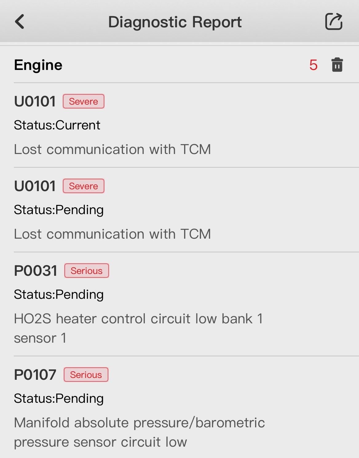

Hi, i just took the battery to get load tested today. it was 12.71v and 880cca. He said it was good

Im going to check TCM connections and wire.

All those codes are generic OBD2 error codes that are pretty much useless with these cars except for very basic troubleshooting of things like "You forgot to put the cap back on the fuel tank". You need a reader that can talk to the car's various modules and get the extended LR-specific DTC's (Diagnostic Troubleshooting Code), like the Autel AP200 Bluetooth scanner (something like $60 from Amazon and includes one vehicle family diagnostic with the price) or the specific Jaguar-Land Rover diagnostic unit from iCarsoft, also available on Amazon. Without that you're going to waste a lot of time chasing your own tail.
The full Repair Manual and Wiring Diagram document (well over 2,000 pages) is freely available for download in PDF form, the link is available here. Just search for it. The explanation of the possible causes of error code U0101(-87) is on pages 66 and 67 of the repair manual.
