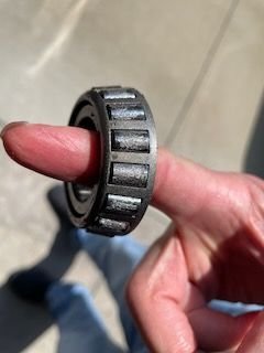

99% chance that it's the outer pinion bearing on the rear differential. It's a fairly big job but you can do it on the workbench of you're handy. I did mine back in April of 2022 and it's still running quietly today. It requires a special tool to get the differential apart and put back together, but it's widely available on eBay and elsewhere. Some good videos out there on Youtube also. Mine had run for maybe 10K miles making noise, and this is what the bearing looked like when I got it out:
Some things to consider: Service the Haldex unit at the same time - there is a filter, fluid and seal kit for it that makes it easy.
