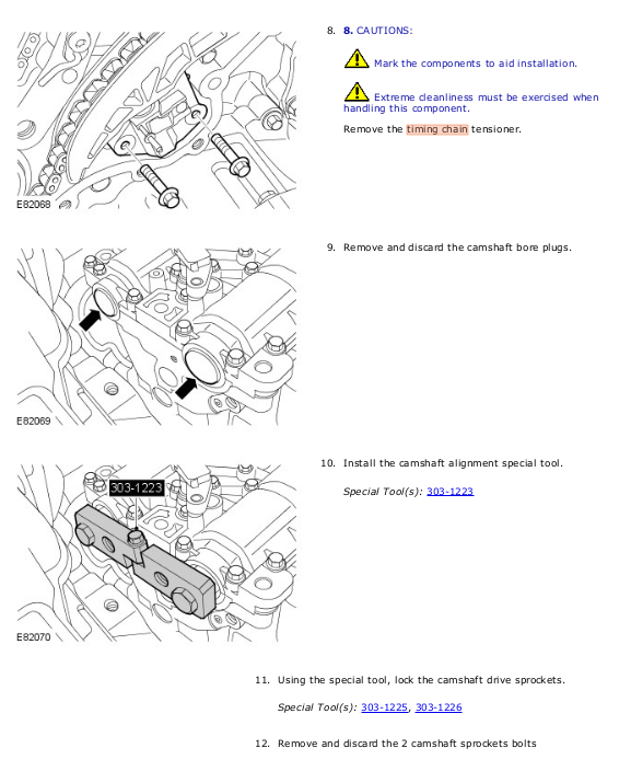

Anybody done a timing chain on a 2008 land rover LR2 that wouldn't mind helping me out a little? I'm currently stuck as I am pretty new to Land Rover's in general, I've gotten most of what I believe to be in the way out of the way to accomplish this daunting task but I do not know how to remove what I believe is the accessory drive pulley. It looks like a solid pulley or is that a cap on it? Thanks in advance.

Flybd5 Thank you very much for all that great information what i am having trouble with is the cover on the accessory drive pully could you help me out with the removal of the "cover"? Thanks in advance.
I am not sure what you are talking about. Got a pic or two?
