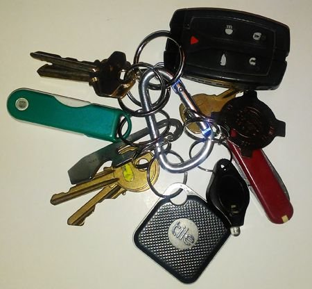

As mentioned in the other thread, heavy keychains can torque the key fob and create issues with insertion/ejection. I made my wife remove her heavy chain full of trinkets and just keep a house key attached to the fob.
Ha! Good point. My wife has nothing on her FOB after I told her removing it when it won't come out is on her.

I think that will be the route I have to go too no more heavy keychains for the LR2

Turns out, you were right, the mechanism was jammed and the locking tabs were stuck.
By forcefully pushing the FOB into the receiver, it was able to break the jam free (with a loud audible click) and the mechanism is acting as it should now and able to properly shut off the ignition power.
I'm going to tell my daughter that she needs to just use the FOB without keychains from now on as well. 😉 great advice. Pretty sure her keychains were weighing more than 1-2lbs
Thanks so much for the info and help. I'm hoping that releasing the mechanism will allow it to continue to operate as it should and no further issues. I'll post back here with my findings after using it for some days like this.
