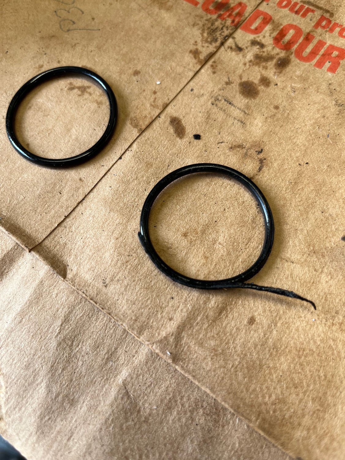

And to top it all off the Haldex pump o-rings failed and pumped out all the fluid. So now there is is an HDC fault and the car locks up in reverse. I finally got it to back up to get into the garage and up on the Quick jacks.

If you R&R or disassemble the haldex, I'd replace any seals or orings which are disturbed. Had the same thing happen once.

What really bugs me is that the kit I purchased came with new O-Rings for the pump. I also replaced the input flange seal. Can’t even get another kit because the seller took it off eBay.
I have a Liter of Volvo fluid coming and will reach out to Jake Kaplans parts department to see if I can get the o-rings. Otherwise I may just spring for the big buck replacement pump. Seems silly for a few bucks of o-rings but there doesn’t seem to be any other option at this point.

Mystery of the leaking Haldex pump solved. The outer o-ring got pinched on installation. I ordered some o-rings from McMaster Carr. if it works out I will start a new thread with part numbers.

The O-rings from McMaster came in (all 75 of them), Got 2.5mm x 31mm ID and 2.5mm x 33mm ID. Fit perfectly and (so far) no more Haldex leak. Found a quart of Fuji fluid on eBay for $38 bucks and arrived next day out of Mass.
