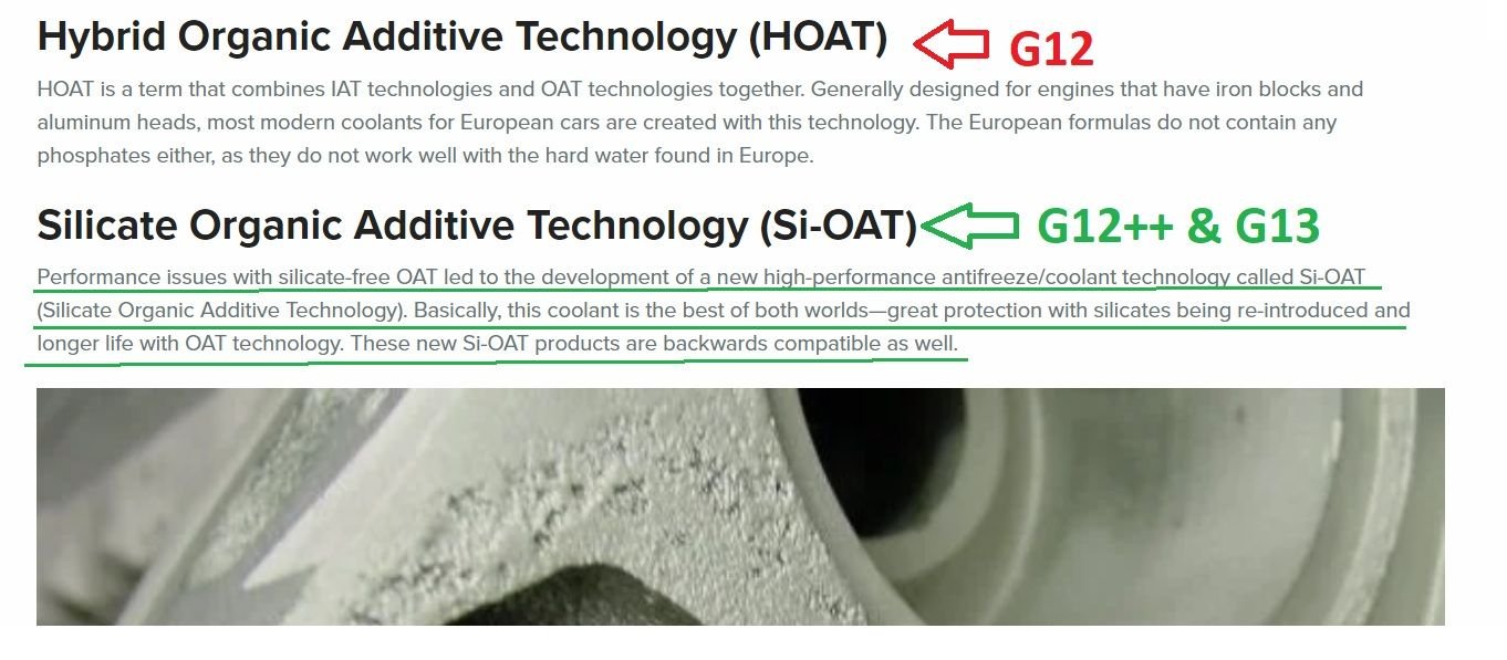

Originally Posted by LR2driver
Why did you say that you would not use G12?
The easiest way to answer your question is to highlight a screen shot from the link that I posted above
But if you really wan to know why......
The 3.2 (Volvo \ Land Rover built by FORD) has two stacked aluminum plate heat exchangers. I believe that the plates are furnace brazed. These plates are very thin and it doesn't take a lot of corrosion to cause the plates to fail. The way the heat exchanger works is Coolant is passing thru the even number levels and Oil or Transmission fluid is passing thru the odd levels (it alternates Coolant, Oil, Coolant, Oil..........) When the exchanger fails with the engine running Oil will enter the cooling system because the oil pressure is higher than the maximum pressure in the cooling system. The pressure relief cap for the cooling system will open at about 15 PSI and the mixture of coolant and oil will make an enormous mess.
I avoid all of this by using G13 and changing it every 5 years.
Take a look at this link
https://landroverforums.com/forum/lr...heating-85879/
Screen shot explaining why I use G13
G12 vs G13
