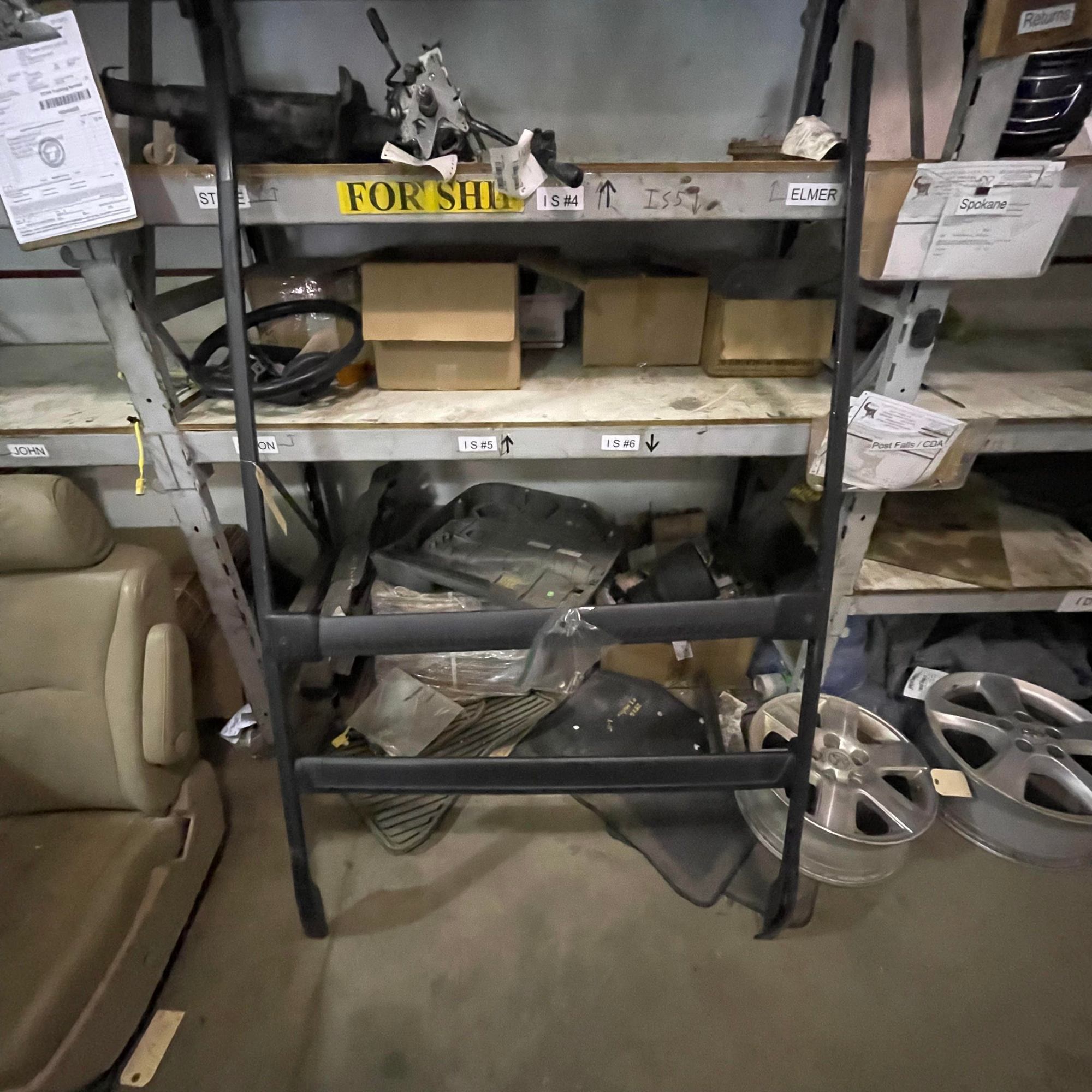

I've been looking for an OEM roof rack for my LR2 for a long time now. They have them on fleabay but $600+ and with only one cross bar (what did LR think we would do with one solitary crossbar???)
The other day I checked car-parts.com to see if any racks from wrecked LR2's were available, two hits came up and no one would ship. Two days ago I checked again and BINGO, found a set in Washington state, and they would ship. $200 with shipping included and all the hardware. Yes! He shoots! He scores! If there are any cosmetic issues I still have the paint I used to switch the fender vents from tacky silver to tactical matte black.

get new bolts! Also, from LR, there are two (removable) crossbars used to carry weight and 1 (fixed) crossmember used for rigidity. It does not take weight.

Why new bolts? And the OEM roof rack does not come with any crossbars.

A tip for anyone reading this thread and considering doing the same -- make sure the junkyard removes and sends you the washers and threaded studs that were inserted into the factory-drilled holes in the roof so you can mount rails. Without that you may have to spend upwards of $100 to buy a "fixing kit", p/n LR006610, that includes parts you may already have. Turns out the folks I bought the rails from had removed those parts and bagged them thinking they could make a buck on a separate sale. I managed to "convince" them otherwise.
