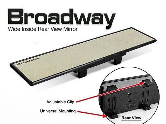

I found that the dimmed mirror in combination with the tinted rear window was too dark to see anything. During the second week I owned my new LR2, I decided that the stock mirror was a no-go. I purchased a Broadway clip-over mirror, flat (not convex), not tinted, sized 270x65mm. Simplest and cheapest upgrade I've done for this car.

I use the convex version, works great. I transferred it to the LR2 from a previous vehicle.
