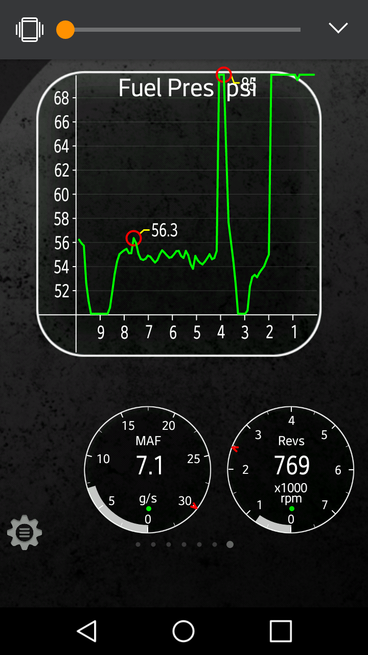

I recently had my engine replaced with a used engine that came with sensors which apparently are the original items. After a few weeks of driving with this replacement engine, the engine light came on with code P0193 (high fuel pressure). There was also some intermittent hesitation while driving.
The fuel pressure should be 55psi after the car is warmed up. I charted the live data on my handy OBD2 app (Torque Pro) and observed that the pressure would sometimes jump around with spikes well above normal. I discussed with my local shop and they indicated this is most likely a problem with the sensor when you see erratic readings like this. A true fuel pressure problem would tend to sustain an abnormal reading for a longer period of time. Also, my fuel trims are in single digits which also suggest the actual fuel pressure is okay because the trims are not trying to compensate for a fuel delivery issue.
I replaced the sensor and the fuel pressure is now back to normal. Following are the before & after screenshots from my app. The horiz scale on the chart represents ~10 seconds of time.

Are you using the generic Fuel Pressure display graph and selection in Torque Pro?
Yes, I selected Fuel Pressure from the list of predefined indicators in the app. There is another predefined indicator for Fuel Rail Pressure, but that does not receive any data for my vehicle. I did not create this display using a custom PID, although I have created custom displays for other things.
I keep an OBD2 bluetooth dongle in my glovebox (VeePeak OBDCheck VP11) that I plug into the OBD2 port whenever I want to see what's going on using the app. I also have a second app on my phone, OBD Fusion, but I find myself using Torque Pro more. This is handy when I'm out driving since I don't carry my dedicated OBD2 reader around with me. Nothing more annoying that seeing your engine light come on and not knowing what's going on.

Got mine running, thanks! I now need to recalibrate the display scale to really zero in on the range. Right now, it's almost a straight line right around 55 psi by my estimation.
