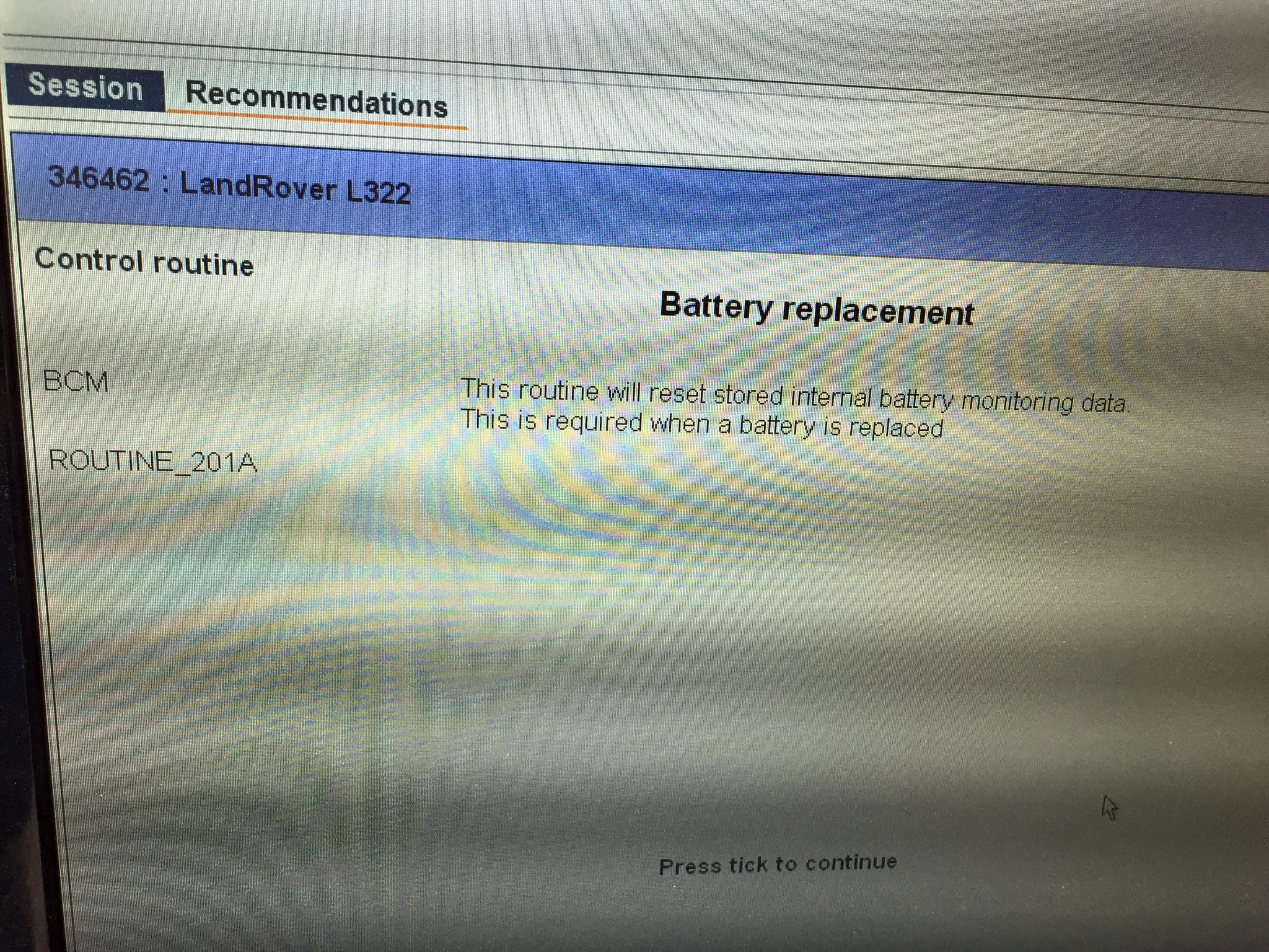

I would try and find out why the alternator light occasionally comes on. Most cars today have a very "smart" power management system and I suspect that if the car thinks the battery is weak or the alternator output is less than desirable, it can actually reduce or disable some features.
We see this a bunch on BMWs. Cars w/ recent battery replacements will come in because certain features won't work and the A/C fan blows at 50%. Registering the battery in the power module restores those functions.
I can't find it in print that the LR2 does the same, but I do know that I have done Batteries in LR2s and when hooked up to the factory diagnostics, there was a "battery replacement" special function.
Its just a guess, hard to say without seeing the vehicle.
The picture below is for a L322 (full size) but the LR2 had similar

what year is your LR2? if it has a battery monitoring system then you will need to have the battery replacement function ran at the dealer. basically what can happen is vehicle will still think that the previous bad battery is in and will limit certain functions to save and distribute power to the more important functions
