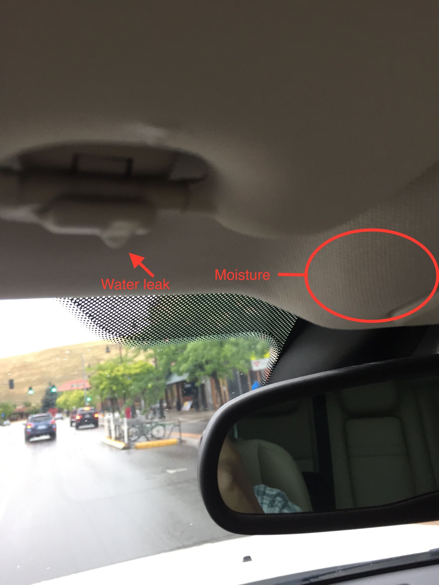

I was driving to work this morning after a very rainy night where my LR2 was parked outside. When I left my house and took the first corner, water started leaking out of the sun visor latch on the right side of the sun visor. (See picture) The sun roof was closed all night, and I am not sure how the water got in. I noticed a wet spot in the fabric of the ceiling next to the over head light to the right of the sun visor. Has anyone else had a problem with sunroof leaking? And if so, what can be done about it. There is no obvious damage, or torn seams anywhere, so I am not sure how the water is getting in. Any info would be helpful.
Water leaking through the sun visor clasp. And moisture next to the overhead light.

Either:
1) Your drain holes are clogged and need to be cleaned out. The sunroofs have drain holes for water that gets in the sunroof tray, at least the DI and DII's do. They need to be blown out with air occassionally.
OR
2) Your sunroof just leaks. Im not familiar with the LR2 setup but the DI and DII are well known for leaky sunroofs and no easy fix in sight.
The water that has already gotten inside yours will cause rust and headliner sagging, bad. Better find a solition or dont ever drive it in the rain again.
