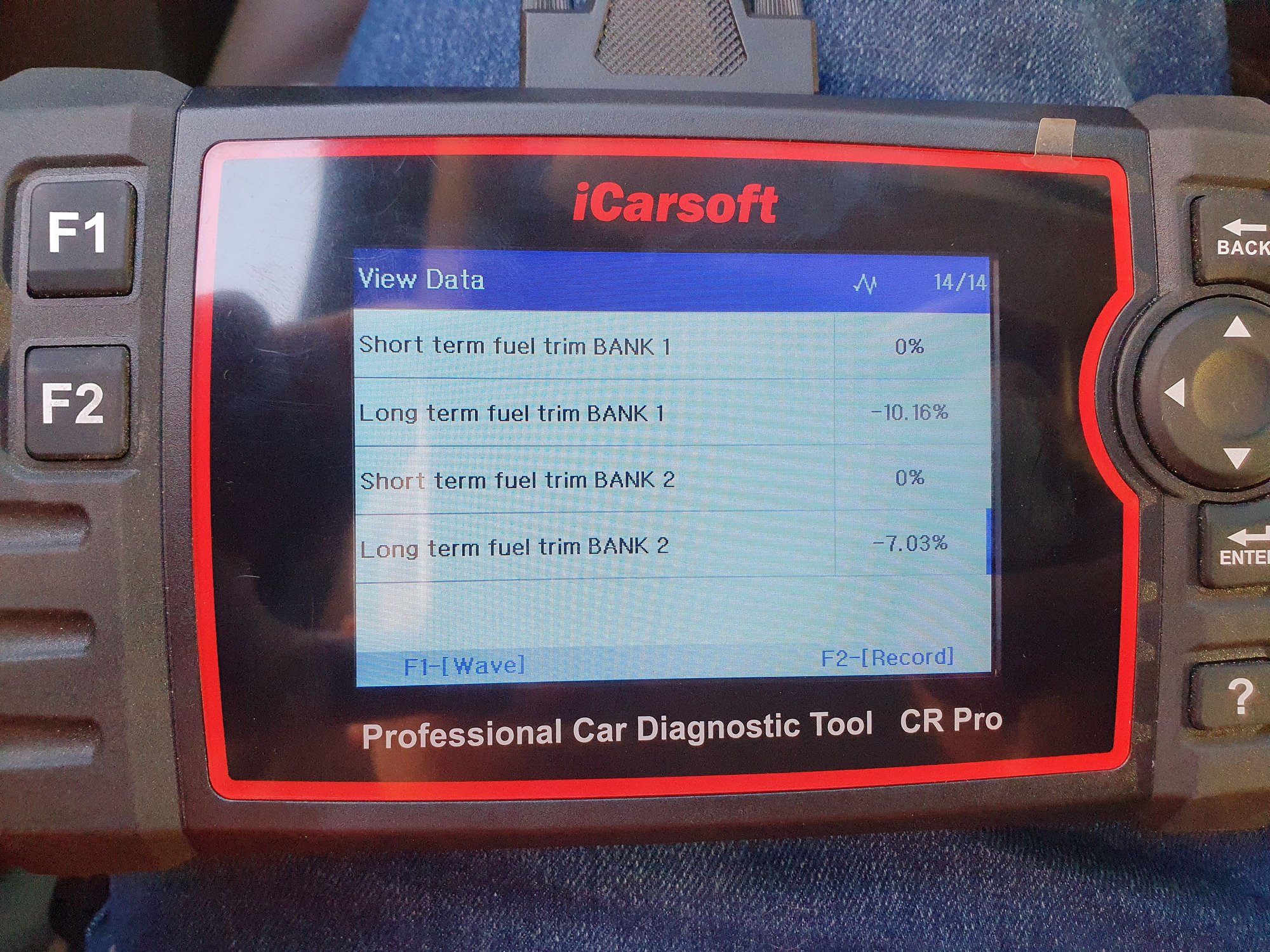

I don't think there is a vacuum leak , I checked the fuel trims and mixture is not lean at all .
However when the fault occurred today i disconnected the air intake hose from the air cleaner box , it started poorly.
Reconnected hose and everything was fine again , makes me suspect air filter or MAF , I also noticed that the air intake hose to air cleaner box clamp was missing.

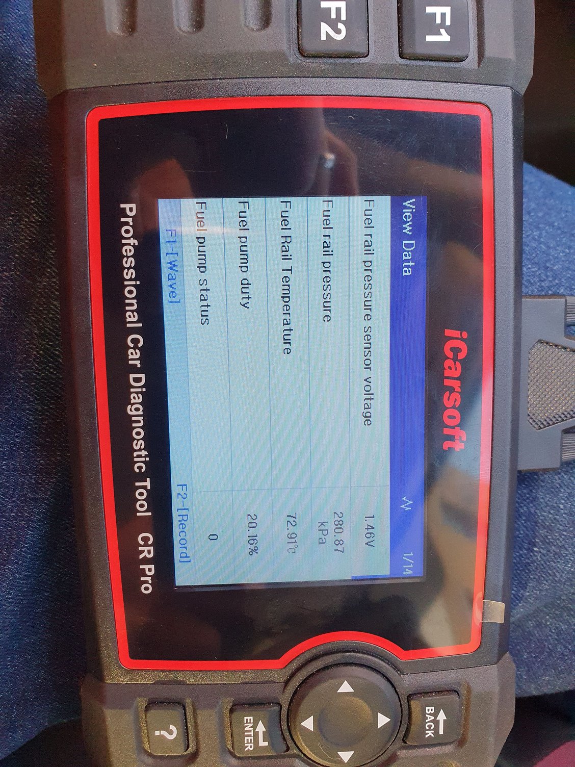

here are some live data attached from my scan tool .
At this point car was hot and fault active .
