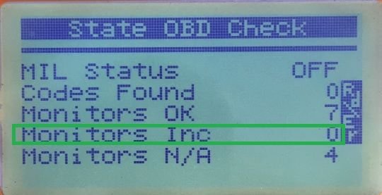

Originally Posted by p_gill
However for anyone that needs to get their emissions checked this won't work.
The OBDII diagnostics have monitors https://www.deq.virginia.gov/Program...DMonitors.aspx
Every time you remove power from the Land Rover ECU the Monitors will be set to incomplete
Where I live incomplete monitors = fail
To reset the monitors typically takes a week or two (without removing power)
Let us know if you fail your emissions check
Thanks
Paul
For a week before the smog check, he could drive the LR2 and leave it on a power supply when not using it.
Old Apr 30, 2021 | 12:57 PM
p_gill's Avatar
Joined: Dec 2015
Posts: 450
Likes: 336
Blair,
I recommend that anyone trying this this approach confirm that the monitors do in fact reset in a week with their driving.
Note: for my S80 with very similar systems (the LR2 is based on the S80, FORD owned Volvo and Land Rover) the reset was very difficult.
My son driving his regular commute did not reset the monitors on the S80, I had to get him to drive deliberately to get it done.
For reference on my Audi a full year of typical driving didn't reset the monitors and to get them to reset I had to do something that I would never do on a typical commute.
The good news: after disconnecting the battery on my LR2 (which sets the monitors to incomplete) and driving for 4 days by the same son that had difficulty with the S80.
Thanks
Paul
