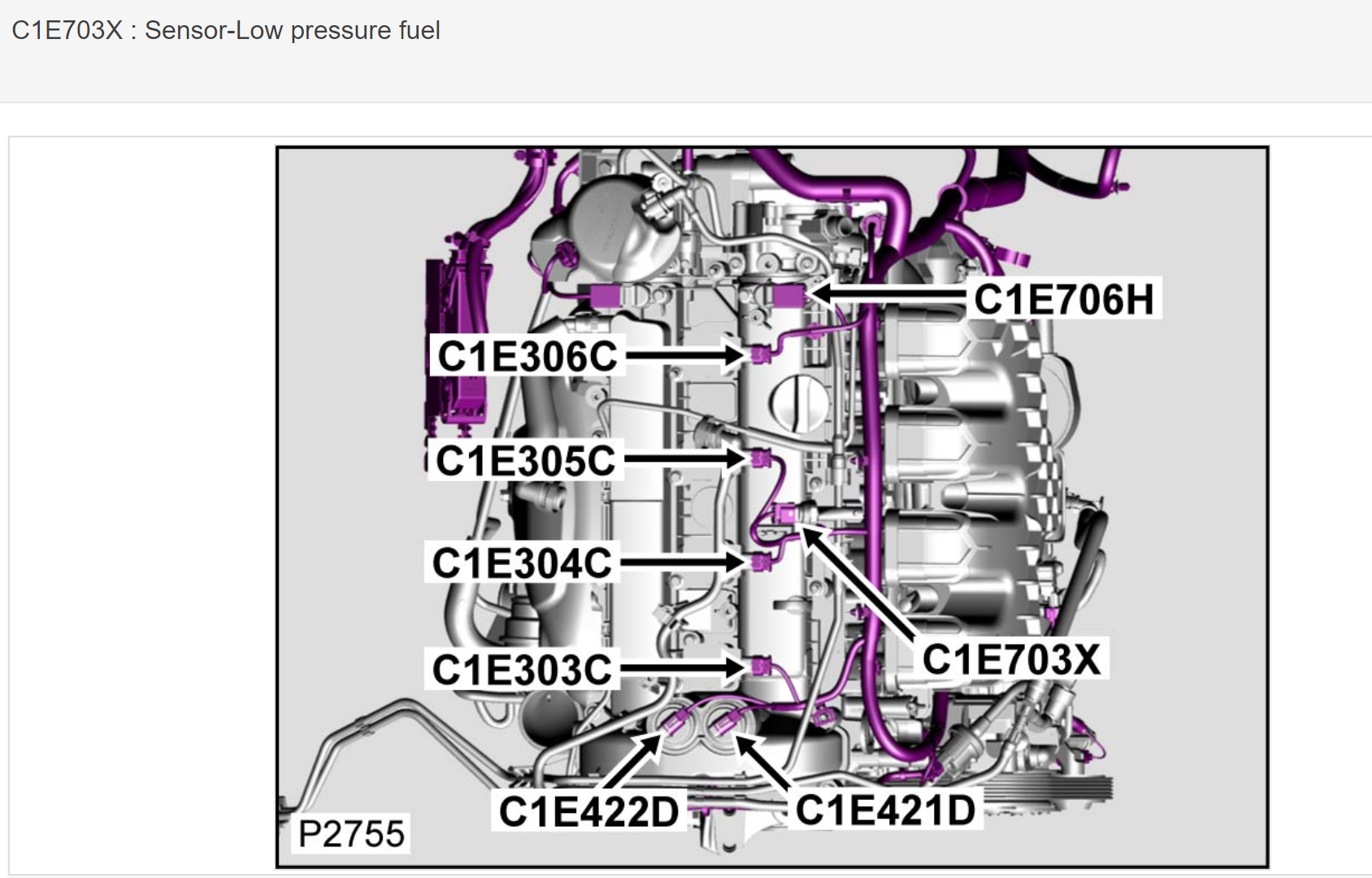

Old May 9, 2024 | 05:44 AM
Hugh166's Avatar
Joined: Mar 2012
Posts: 106
Likes: 27
From: NYC
It is right on top of the engine, just to side of the oil fill cap.
Old May 9, 2024 | 10:43 AM
geotrash's Avatar
Joined: Jul 2007
Posts: 504
Likes: 58
From: Richmond, VA
Yup. Very common failure and usually both easy and cheap to fix with a new pressure sensor. Had to change mine out at 214K.
