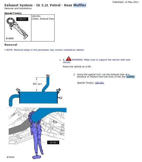

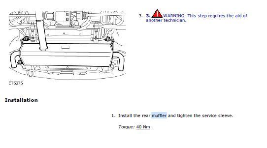

Hello, I recently purchased a replacement muffler for my LR2. Is there anything more I'll need to install the muffler, such as clamps or anything else? Thanks!
