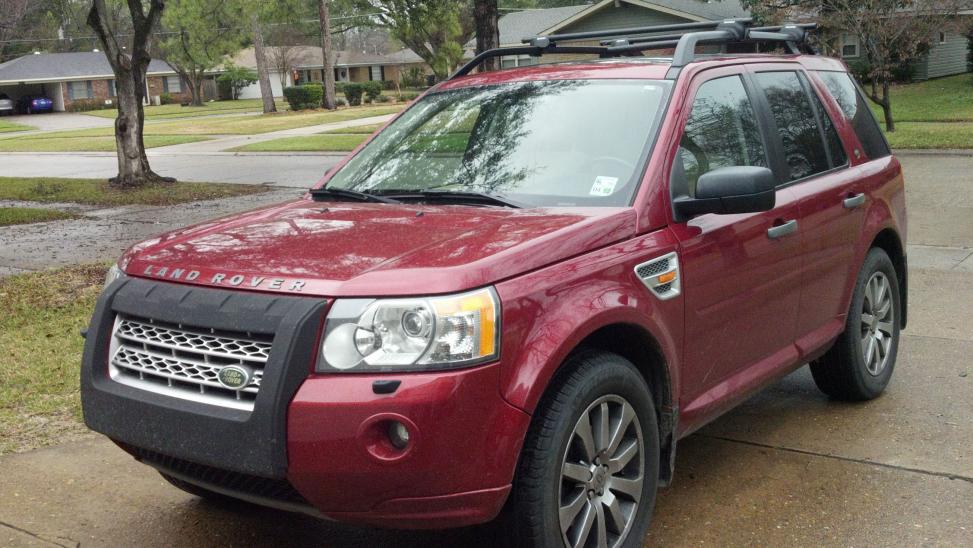

I did some research, took some measurements, talked to my dealership to insure warranty guidelines, and tried on a couple different sizes of tires on my 19" wheels in my 2008 LR2 and came up with this solution:
I've got the 19" wheels and have put P255/60 R19's on mine -- Michelin Latitute Tour. They are both wider and taller. And because they're taller, the sidewall doesn't come any closer to the suspension behind the tire, even though the surface of the tire is wider. I thought I was going to have to install spacers before I fit them, but that turned out not to be the case. The shorter the tire, the more bulge on the sidewall. Inversely, as here, the taller the tire, the less bulge from the sidewall. This is a really nice fit, no spacers needed, no rub. The only thing that's different is that you'll manually have to correct the 6% increase in speed/milage/odometer over what the car's instrument panel will register (you're going faster than what the speedo is saying!) I've had these on there for 18k miles and no complaints! No decrease in mileage (possible increase actually) and the ride is smoother, with a little added clearance, and my rig looking more like a capable SUV and not so much of a car. They're wearing very good too. I'm looking forward to getting more miles out of these than my Continental's. Tires in this size range are cheaper as well.
OH, this tire size calculator was very helpful: http://www.miata.net/garage/tirecalc.html . The OEM tire size I upgraded from was 235/55 R19, which wore down in barely 30k miles.
See these pics I snapped the other day:
Let me know if you have any questions or comments.

WOW!! Those look great! I was looking into the Pirelli Scorpion ATR tires. They are 255/55R19. So are you telling me that they will fit!?!? If so I will be so excited!
Old Jul 12, 2012 | 07:45 AM
douglasson's Avatar
Joined: Feb 2012
Posts: 18
From: Shreveport, LA
Lazerbrains,
Those would look really nice! However, I put on the 255/60's, that fit; but you're looking at 255/55's, which are shorter and could bulge a little more at the sidewall as I understand it, and could rub. I didn't try that size on my lr2. If i were you, I'd go ahead and try them! But I'd have some spacers on hand in case they rub the suspension. The local tire store here was able to find some spacers (1/4 or 1/8 inch) to have on hand, but I ended up not needing them. If those work, you won't have to adjust your speedometers much, so that will help!
Give them a try and please share what you find! That will be good information for the community.
