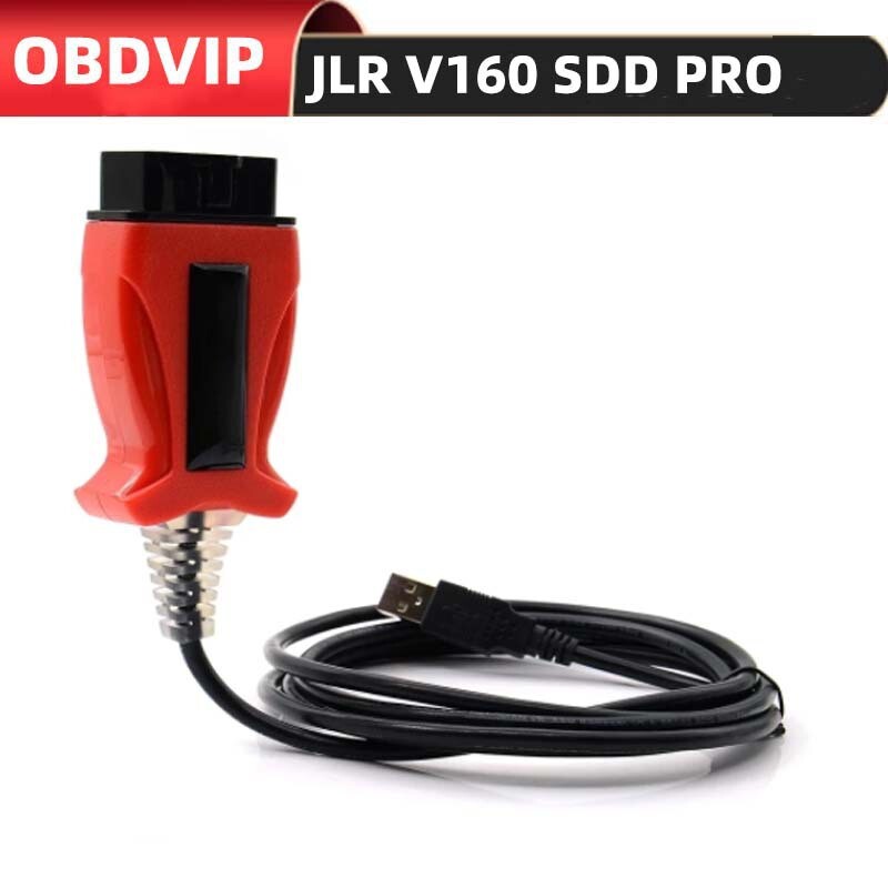

thanks for the quick response and for the Link to manuals. I thought my laptop crashed after it fell off the couch. I looked up JLR SDD--but what i found was the end that plugs into the car--but the other end is like a usb end----what does it plug into? Do you know about how much the JLR SDD cost? ballpark figure? thanks mark

The other end of the mongoose cable plugs into a laptop USB with the software on it. I use a virtual much older version but the links to that are now gone I believe. It was on one of the jaguar forums. You can get the most recent software free to download but will need a mongoose cable (or a Chinese knock off). I guess with the most recent software you will need a key or a key generator (check ebay). It's a bit of a learning curve to learn to use it (it's not intuitive) and you will also need some type of volt and amp battery maintainer (13.5 volts and 20+ amps constant) like a CTEK Multi US 25000 or equivalent (for example). You will have to do a lot of research if you are so inclined.
One caution, if you go down this route, you can end up "bricking" your ride, so the battery maintainer is important if you want to fully utilize the software.
