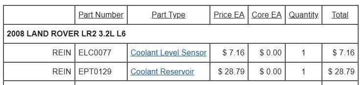

Here's a screenshot of my receipt from RockAuto when I purchased these REIN brand items in 2021. They have worked well.

I would suggest that you don't need the sensor, those probably don't fail. What fails is the foam float that is built into the reservoir.
You can reuse the old sensor, it's external to the reservoir.
Old Oct 27, 2024 | 10:20 PM
flybd5's Avatar
Joined: Jan 2020
Posts: 2,149
Likes: 631
From: Massachusetts
The OEM tanks come with the sensor already, you just plug it in when installing it. I would strongly recommend buying an OEM tank from the dealer. I tried two Chinese tanks, they both failed miserably within weeks. They could not handle the temperatures or pressures.
