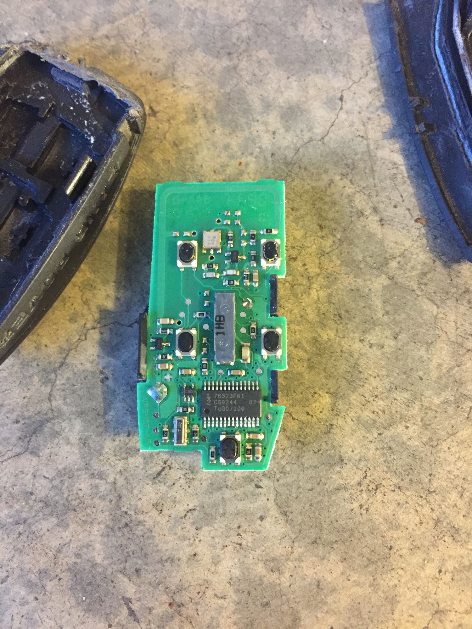

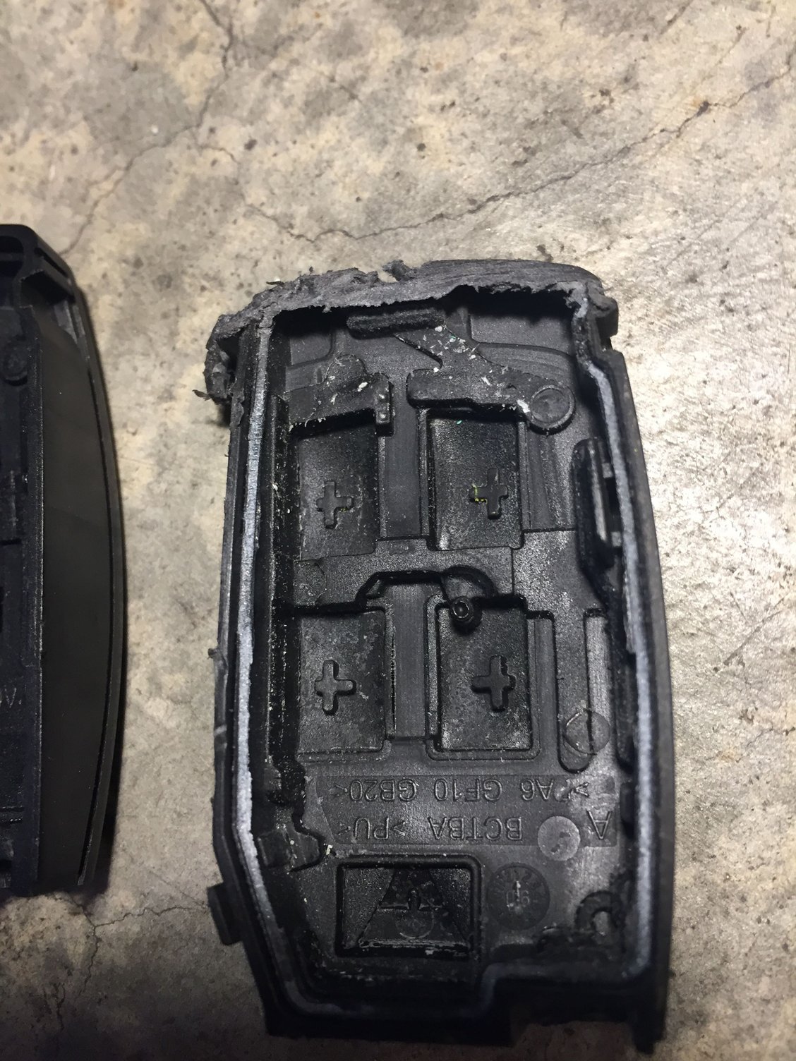

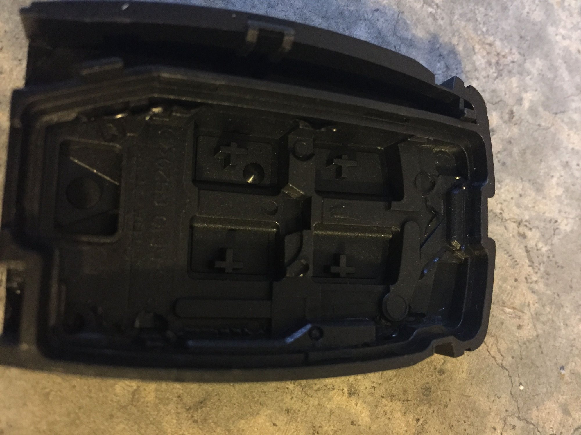

One last thought
Do any of the buttons on the remote work?
The Plastic inside gets worn down and it no longer makes contact with the switch mounted to the printed circuit board
