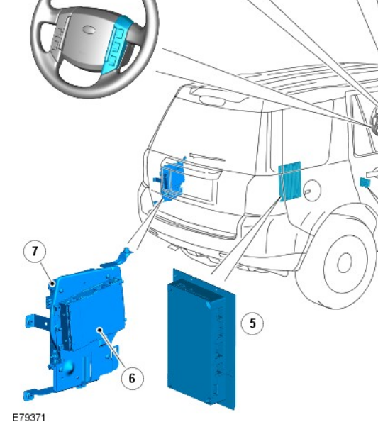

Trying to subscribe to Sirius but when i press the fm button i only have fm 1 and 2 no sat 1 and 2 any help would be appreciated. When turning radio on it says Sirius. Thanks Dave.

Are you sure you have a satellite radio module in your vehicle? It's in the cargo area, left hand side under the side panels.

Thanks looks as if thats the problem i thought as it said sirius when the radio turned on it should be installed

Well, Sirius is now SiriusXM and if it's not configured it should still let you listen to sample channels. If it doesn't, either you don't have a module, or the fuse for it is blown (also in the cargo area) or the module itself is broken. The Sirius module is item #6 in the image below. The fuse is FD3 is auxiliary junction box 4, under the spare tire cover in the cargo area as well.
