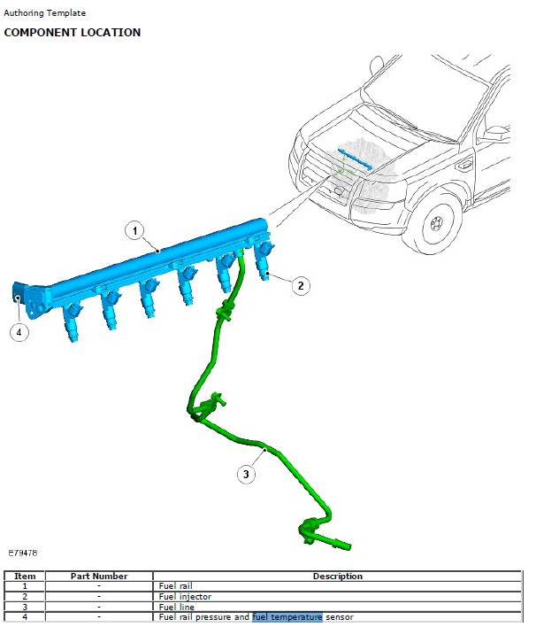

My fuel temperature sensor needs to be replaced. Is the temp/pressure sensor one in the same in a 2008 LR2? or is the temp sensor located somewhere else.
Correct, the fuel rail pressure and fuel temperature sensor are one and the same, it is located on the far left end of the fuel rail as viewed from the front of the vehicle.

Thank you, my rail is reversed. the sensor is at the far right
I'll be damned. Other pics show it that way too. Looks like the one I sent you is reversed in the service manual.

That's not the only image reversed in that manual
