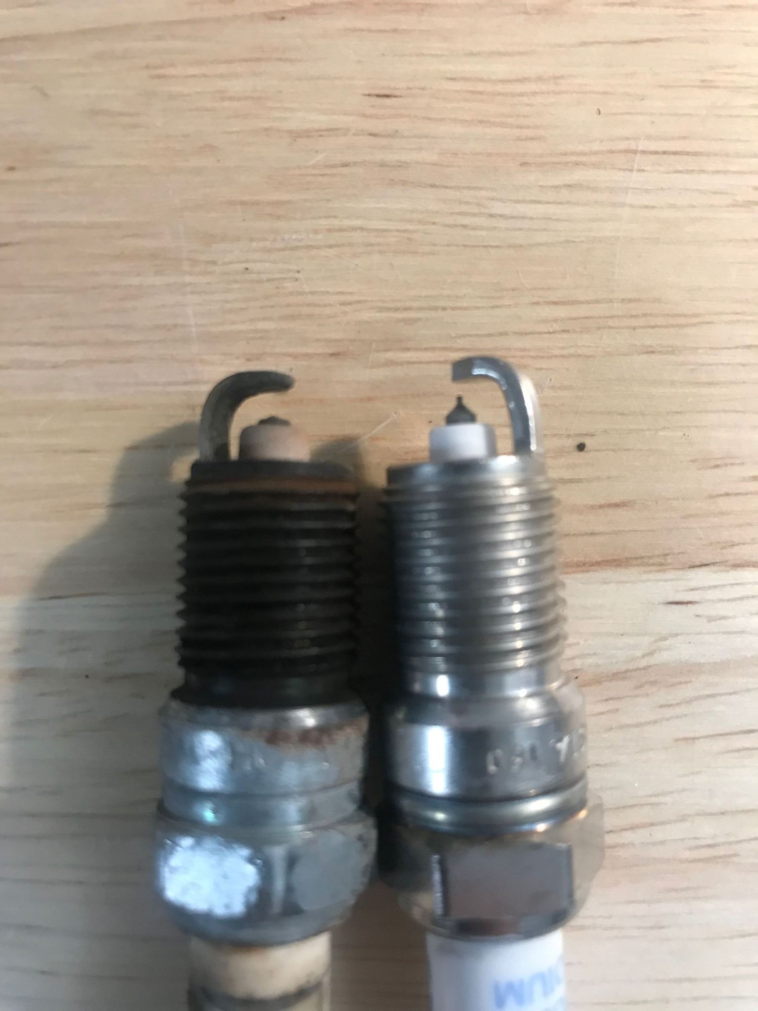

OK - after all the maintenance on the LR2 my conscience was suitably pricked & I started on the much loved and neglected family beater - 04 Yukon 6.0L V8 - suspect the plugs have never been changed (ever) - now at 196k miles (Champion Iridium). Had noticed some rough idle but nothing show-stopping.
old & new - old 196k miles (suspected) - Champion Iridium

Dude... you need to start reading the maintenance schedule sections on your vehicle owner manuals.
