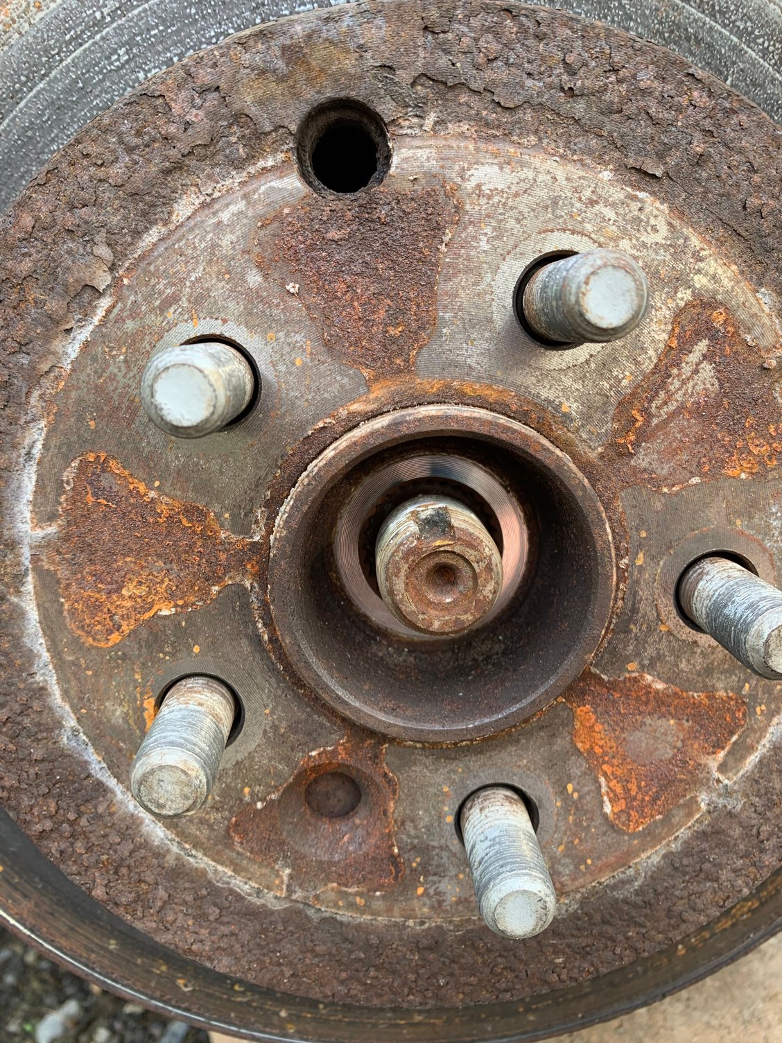

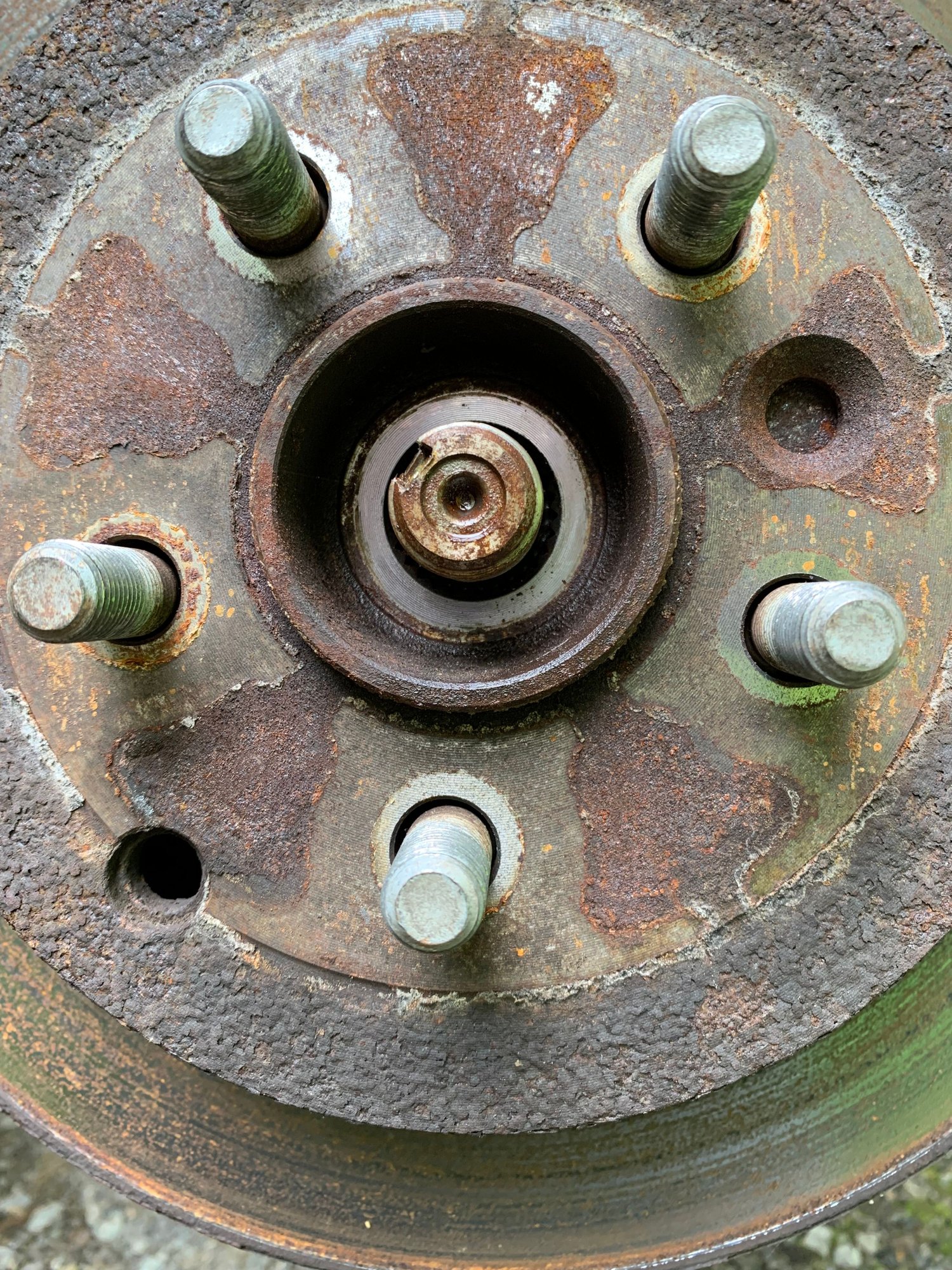

Thanks again folks, been busy at work and haven't posted my progress. I hammered the socket onto the two lugs that were a problem and got them off (may have sacrificed one socket and one lug nut, but I'll work on those later). Now the issue is the rotor. I've removed rotors before; remove set screw tap a little, wiggle, tap some more and pull it off. Well, my 2011 rear rotors have no set screw. I removed the 32mm nut but I'm hesitant to tapping on the back side of the rotor. WTH?

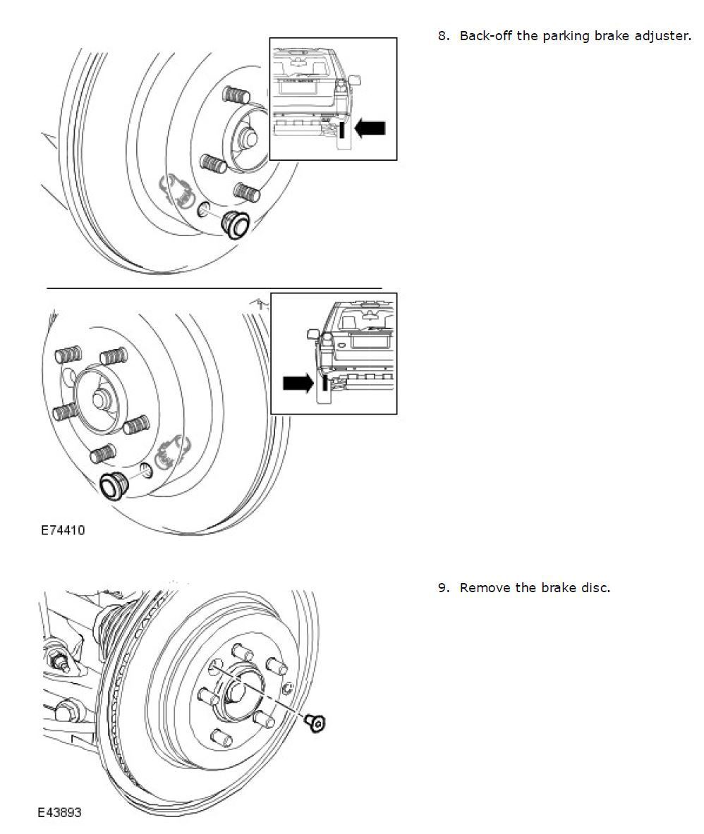

There are two items to remove to take off the rotor, the parking brake adjuster screw that needs to be backed off, and the set screw. Are you saying the set screws are totally missing? Someone forgot to put them back on and that may explain why the wheels won't turn.

That is what I expected. I haven't had these rotors off, but it got brakes done a year and half ago. My apologies, I tried to scale down the size.

I'd say your shop put the rotors back on wrong. The hole for the set screw should be aligned with a threaded hole in the hub, but I just see a blank face.
That also means the access hole for the star adjuster isn't aligned either so you can't back it off
Might have to just beat the rotors off. I'd try to make sure the park brake is released. On some modern cars, an electric park brake won't release for real until it's in drive and you press the gas. Better read the shop manual to find out exactly how it works. Might have to jack it up, start it, and put it in gear to release the brake???
