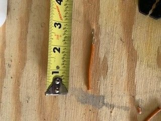

I just used the existing 12v circuit. It was already sufficient for my fridge and charging couple cameras. This circuit is powered only when key ignition is turned on (Key position 2&3) - but there is a quick fix. Pull the 12v relay out and replace with a jumper wire. I used to use a short wire with two male spades to keep it powered. Now I have an old broken relay that I disassembled and hardwired to constant power. Quick swap to make it work either way (constant or switched).

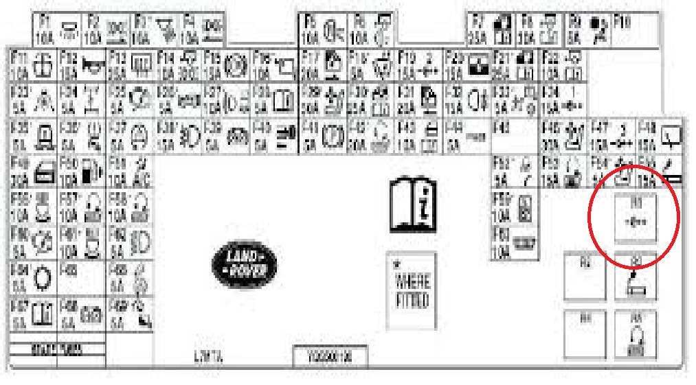

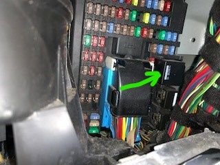

No, the 12v outlet relay is behind the glovebox. I think it is this one:

That's awesome, I got in there last night and was lost. I ended up finding something and I'm sure you are right. I'm going to dig back into it today after work. I also read that it makes the cig 12v in the center always on too. Is that correct? If so I will need to figure out my Bluetooth. May have to route it from the front.

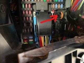

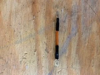

Old Sep 9, 2019 | 01:17 PM
scoutrover13's Avatar
Joined: May 2018
Posts: 163
Likes: 30
From: Middle NC
Pretty easy to do once you get your bearings though is is tight like others have expressed. Unplugged my Bluetooth over night and nothing ill affected my battery. Started up perfectly in the AM.
Also ordered another outlet with USB and volt meter. Will run that once it arrives.
Wire with one spade connector
Wire with spade connectors opposing
Relay pulled
Relay replaced with wire

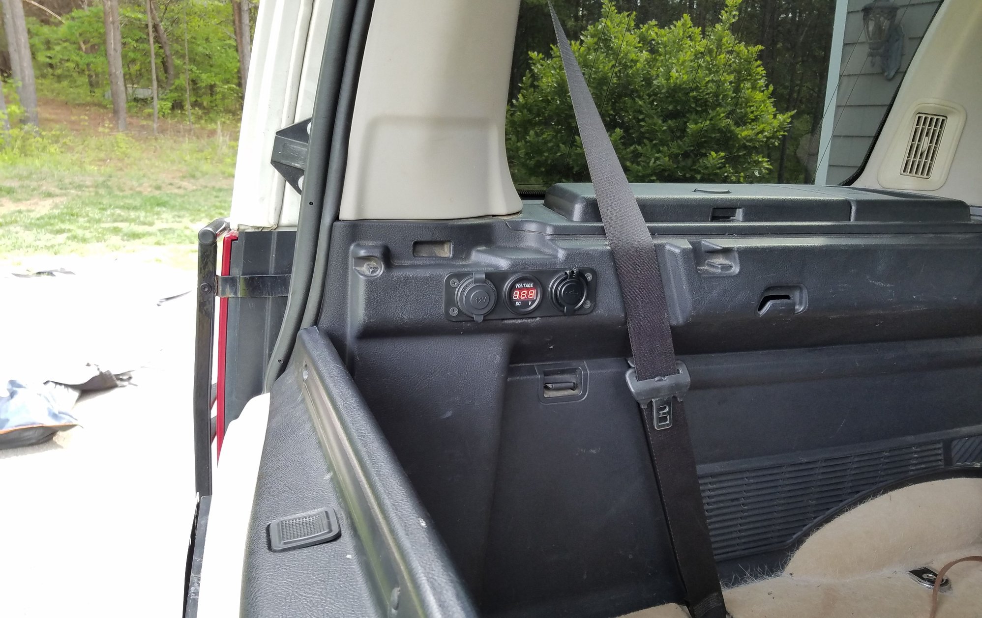

Old Sep 12, 2019 | 06:09 AM
loanrangie's Avatar
Posts: 1,625
Likes: 266
From: Melbourne, Australia.

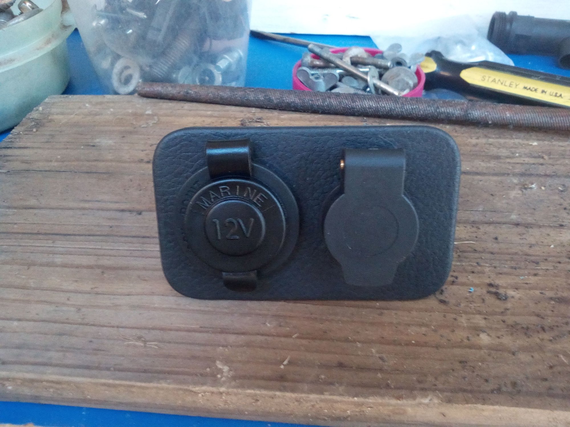

I mounted my sockets on the RH side just behind the 3rd row cup holders, 1 x merit and 1 x 12V socket but yet to mirror for the LH side. Less likely of being knocked out like the original location.
Old Sep 12, 2019 | 07:06 AM
Joined: May 2018
Posts: 163
Likes: 30
From: Middle NC
That is a great location. And looks factory. I like it. Not sure I know what a "merit" socket is (tried google) but I'm guessing a duel USB? Am i correct in my assumption?
