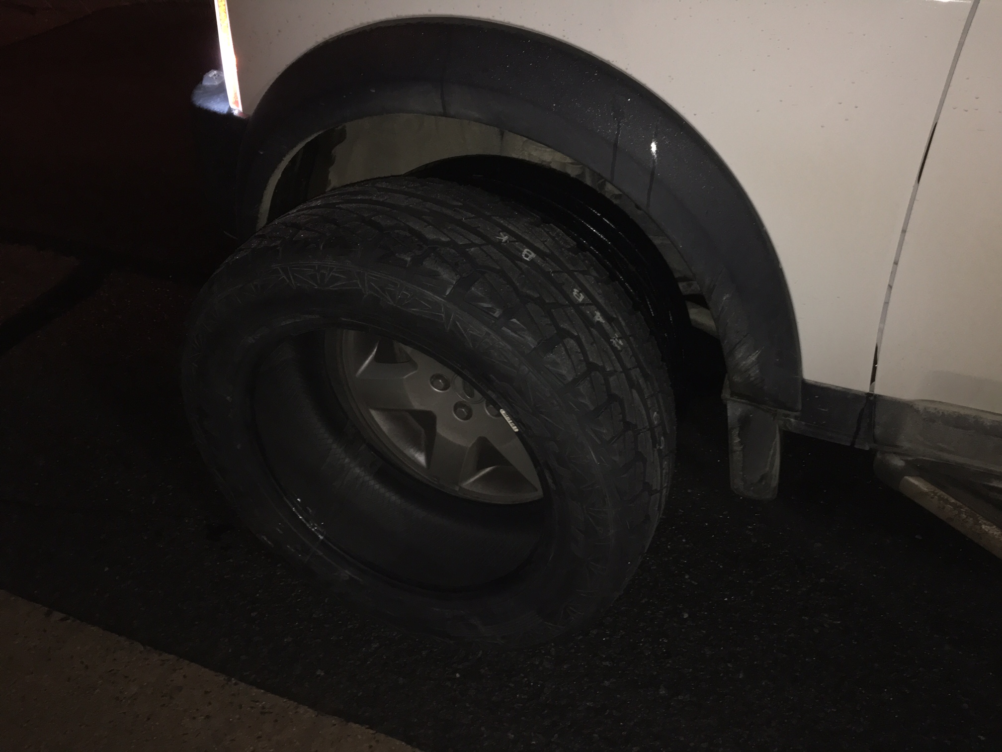

Here you go - pulled the trigger on the 20" tires on Friday so I wouldn't be tempted to keep figuring something out on the 19's (even though I love the HSE wheels) - OR doing something really bad and thinking about 22" wheels! lol.. these came in Friday - hopefully will have the stormer's in by Wednesday with another update.
Obviously you can see how large they car compared to the stock 19" HSE wheels and stock tire size of 255/55/19. I think I made the right choice - better looks AND increased capability.
