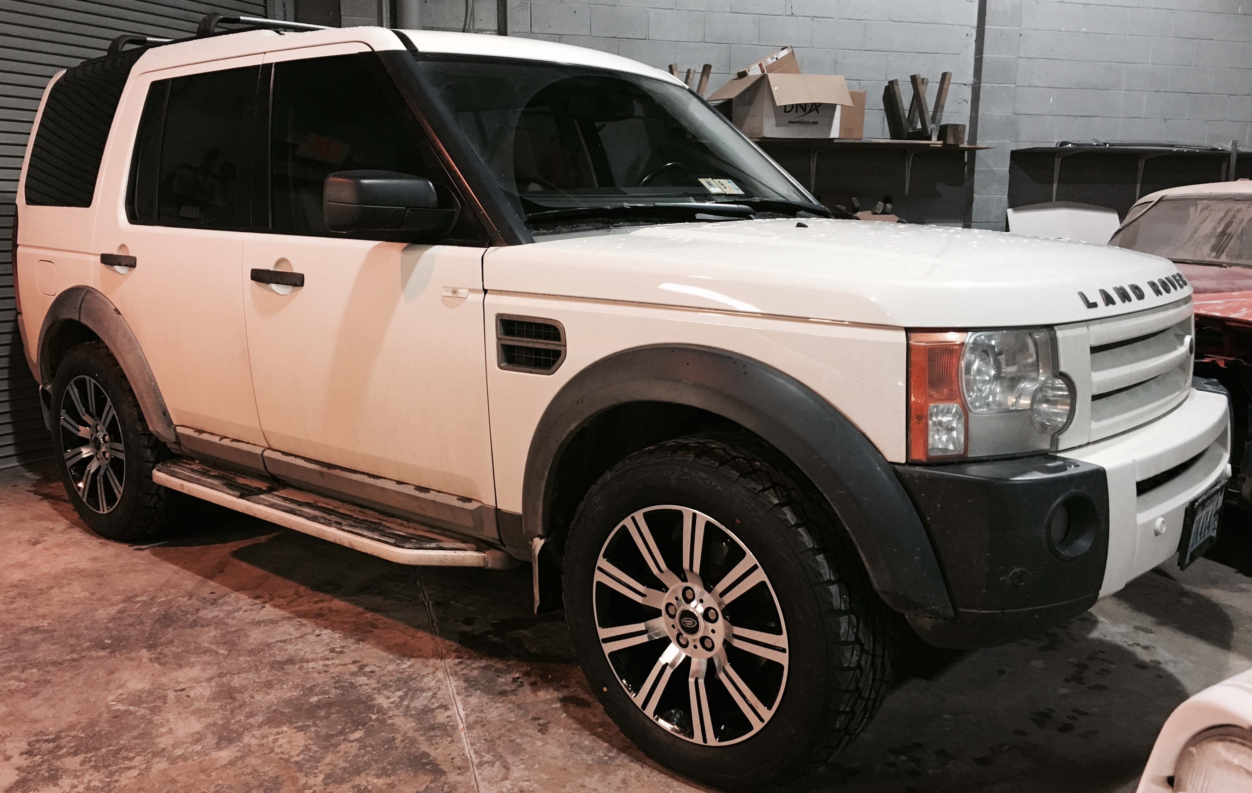

They drove perfectly fine, and while I didn't push any turns or cornering, I didn't hear any hints of rubbing. At 31.9" that sounds pretty good. Then again I think the rhino rods are still a good idea.
Quick shot.

From: North of Seattle
That looks nice!!

Originally Posted by houm_wa
That looks nice!!
Thanks man, glad I went with the OE look. Something about stormers of any kind / color / size on any land over always works out haha. Tire size seems to have worked out well too, even though it's pretty rare.
