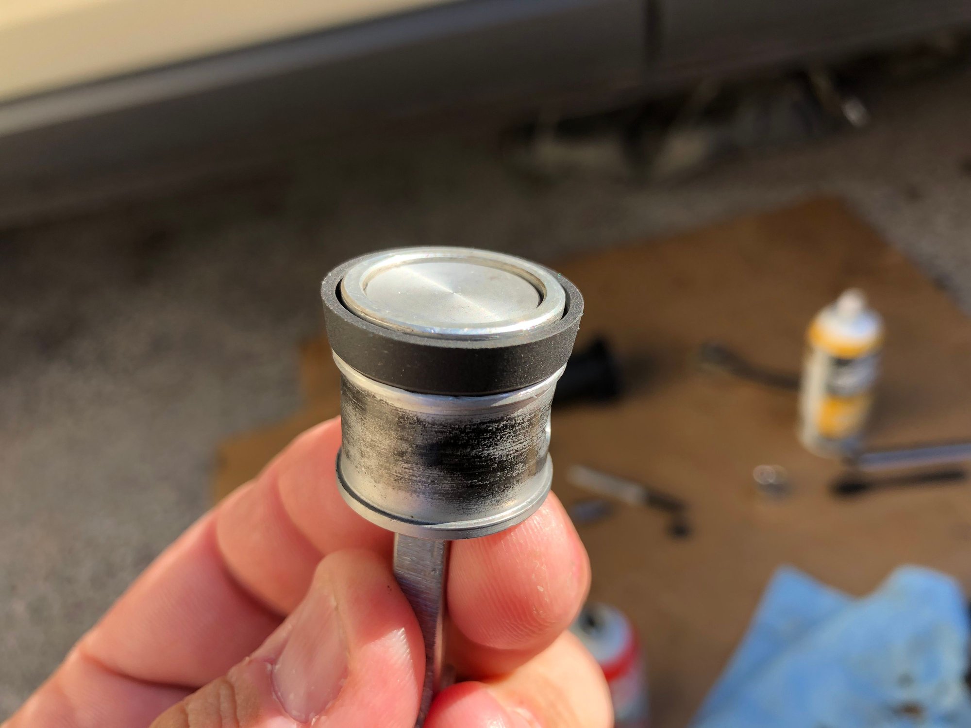

Dont rule out a power supply issue. As pressure builds, it starts to eat up amps. But assuming that is good, then it would seem that it has a performance issue. Typically it is a worn piston/cylinder. Or in particular, the piston "ring" which wears and also wears the cylinder.
Of note! Do not ever lubricate any part of the compressor. It is a dry compressor and any lubricant can gum it up and kill it fast. My dumb *** thought it would be a good idea to use just a little silicone lubricant for the piston. Nope. Dumb. Gummed it up and it did not last long.
Ha. When I pulled the old one apart, it was filthy with lube, seemingly silicone. I wonder if someone had tried to rebuild it, or if it came like that... would explain a lot.
