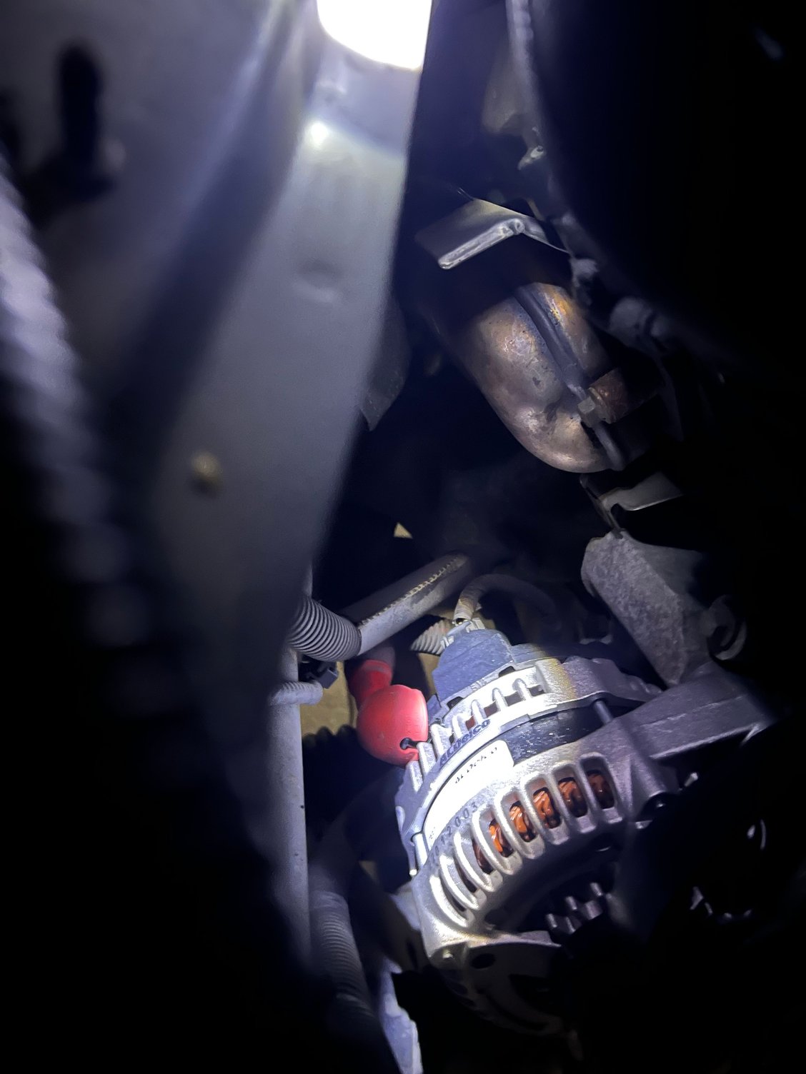

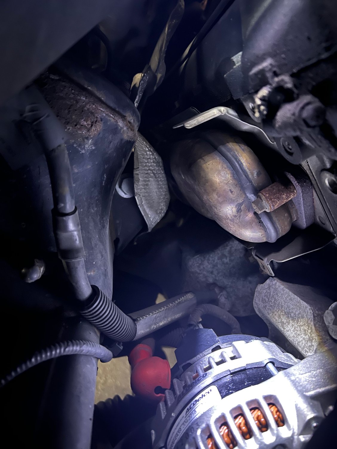

Air filter box is completely removed, you can see where to go in

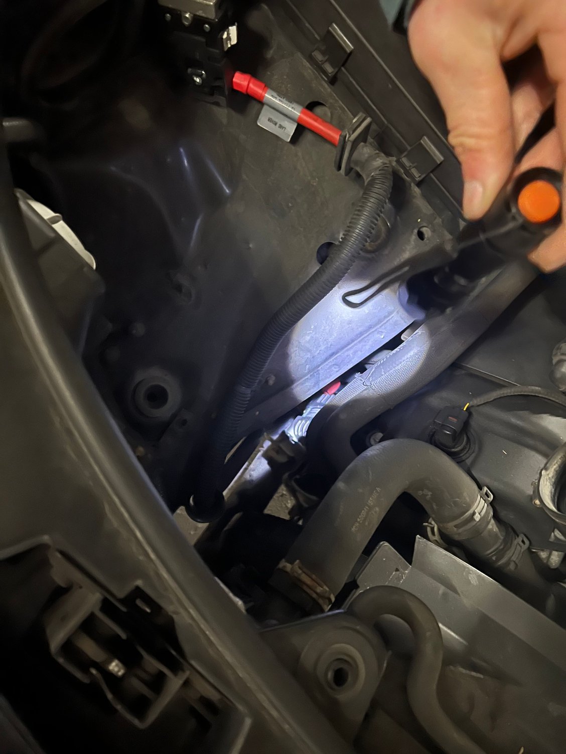

You can see the top connections for the alternator.
Easily snake your arm in and start disconnecting.
