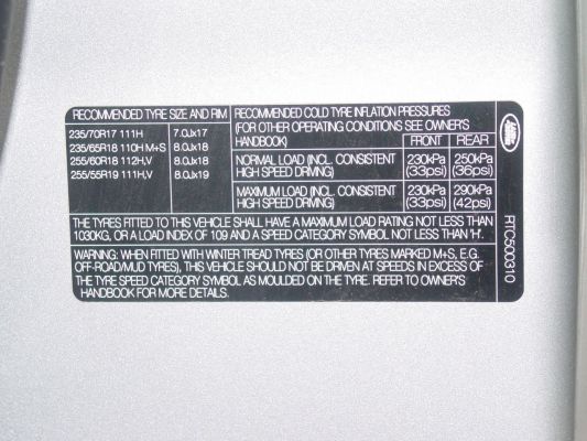

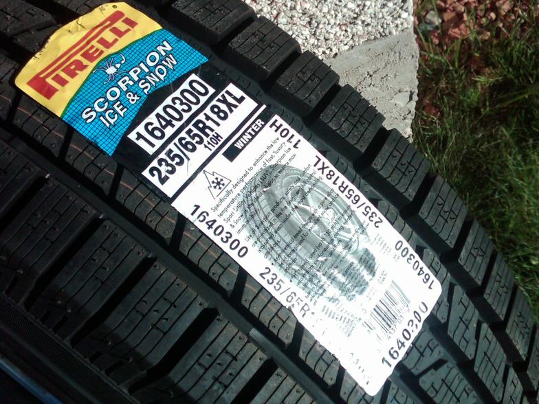

Default 235 65 r18 xl
You live in Colorado and that means snow even in July higher up I suppose; it does here anyway.
For my snow tyres, I installed the narrower "taller" 235 65 R18 XL size that is shown on the door sticker.
I got the Snowflake Ice and Snow tread style but you could probably find that size in an AT for more all around all year use as well.
To my mind, if staying on the road or trail is a primary consideration, wider is only for dry pavement or when offroad, perhaps on sand.
For summer, I have 19" rims so run Bridgestone Dueler H/L Alenza in the stock 255 55 R19 111V XL size.
Attached Thumbnails 2008 LR3 V8SE - Tires-pirelli-ice-snow-235-65-r18-xl-tyre-sticker-tread.jpg   2008 LR3 V8SE - Tires-lr3-tyre-pressure-sticker.jpg
