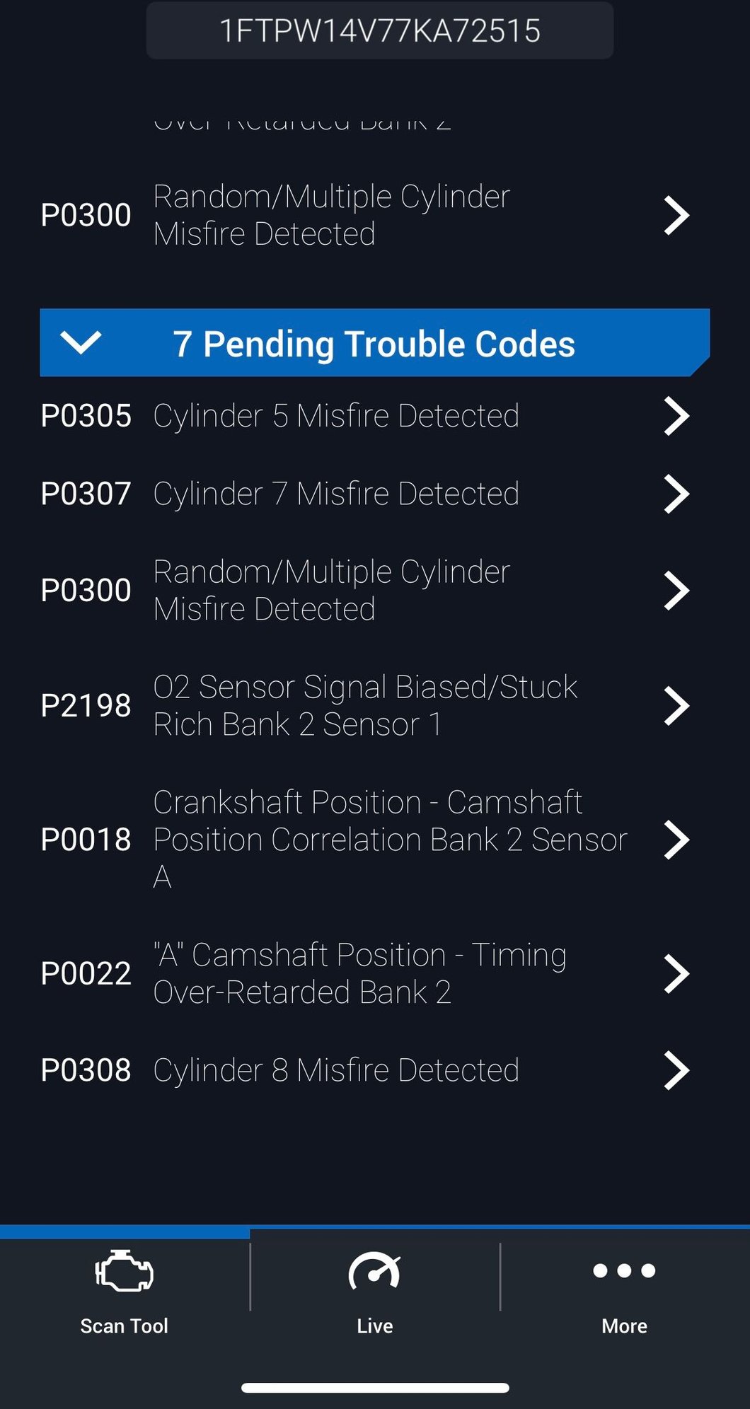

The whole bank misfiring. Any other codes?
A few years back, my 07 F150, 5.4L I thought took a total dump. Misfires on 3 of 4 cylinders on the same bank along with crank and cam sensors, and an O2 codes
In my case the VVT solenoid failed leaving the whole bank off time.
This was my scan when I thought I lost the motor.
